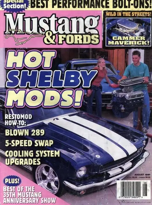

My first time around, I used a 94 Tbird Moonlight blue with white pear stripes.This is the only pic i have around right now,i'll find the others if it interest you.

Perfect...........that's the color combination I'm looking for. I'm looking to get my car painted that scheme and I'm looking for definative codes to give to the painter.

The blue is code KM, the white was a basic pearl with about 5 coats, too much and it will start to take a yellow cast. The paint was used on 94 T-birds and is still used as Electric blue i think on 04 mustangs.
