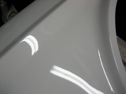

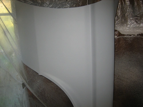

I've got the 43430 gun, it sprays real nice. I thinned my primer down a bit more to shoot out the included 1.4mm tip. Not bad for the price.
Shiny shot above was after wetsanding/polishing. Primer shot above that is fresh out the gun.
Your prep, environment and compressor filtration setup will make or break you.
