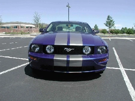

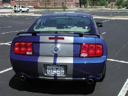

I downloaded the file with the dimensions for the 66-67 GT350 stripes. I had these painted on. The car is Sonic Blue and the stripe color is the stock wheel paint.

How did you guys determine how wide to paint them? The only reason I ask is because STANMAN's are wider....centered almost perfectly over the foglamps. Not saying ones better than the other....just curious. They both look great :nice:
Decison on stripes
Basically, I feel that the wider stripes dominate the lines of the car and I did not want that. I was pretty sure that lines were close to the 67-68's. I have the technical document from Shelby American for painting stripes on the 66-67 GT350 and had the stripes painted according the dimensions provided.
They are 9-3/4 on bumper.
Start at 9-3/4 on the hood and get wider 10-1/2 at the windshield.
10-1/2 down to 10-3/8 over the roof front to back.
10-1/8 over the trunk down to 10 at bottom of the rear bumper.

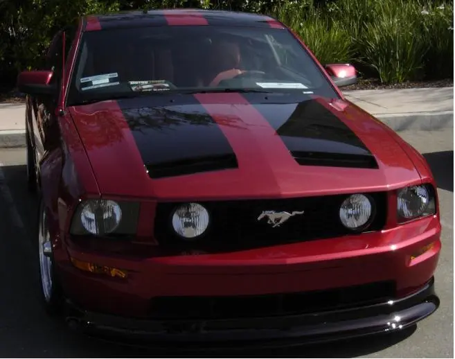

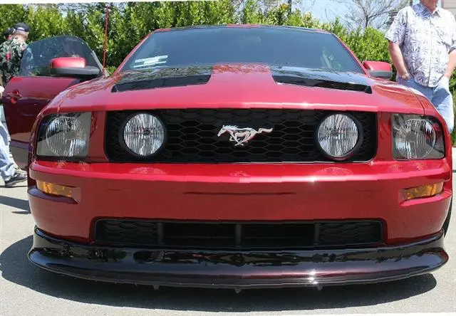

Redfire with dark Red stripes
The stripes look black until it is in the sun. Then you see they are dark red metalic. It is exactly what I wanted.
