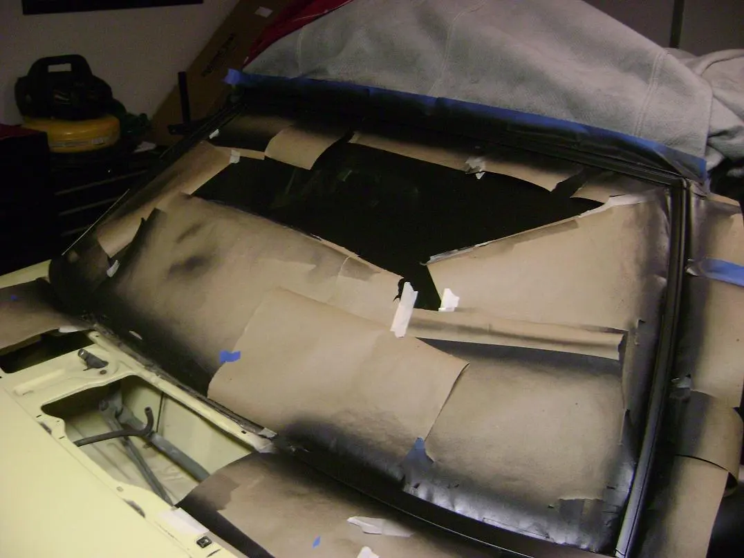

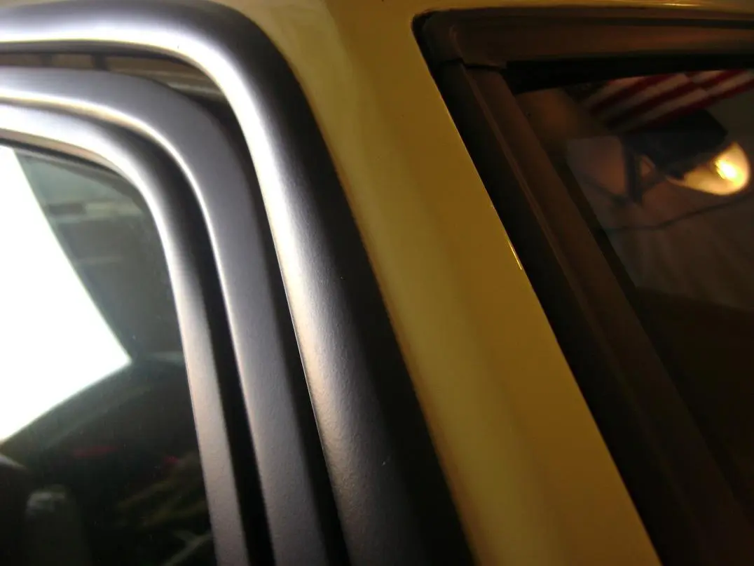

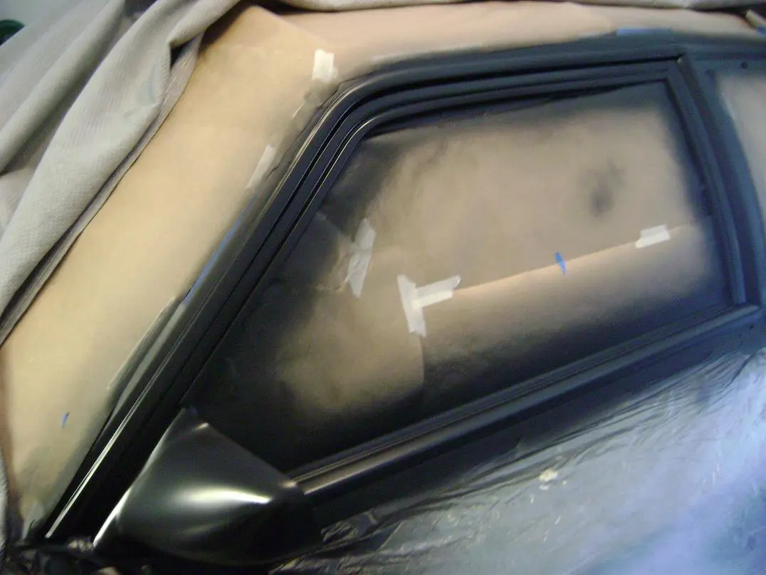

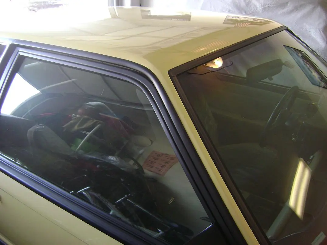

I painted mine during a exterior resto a few months ago. I just left them on the car and painted them. I was able to get masking paper to slip under the trim so the repaint looks as good as if they were removed. In fact I repainted all the cars trim without removing any and it looks perfect. It just takes extra time to mask everything real good.

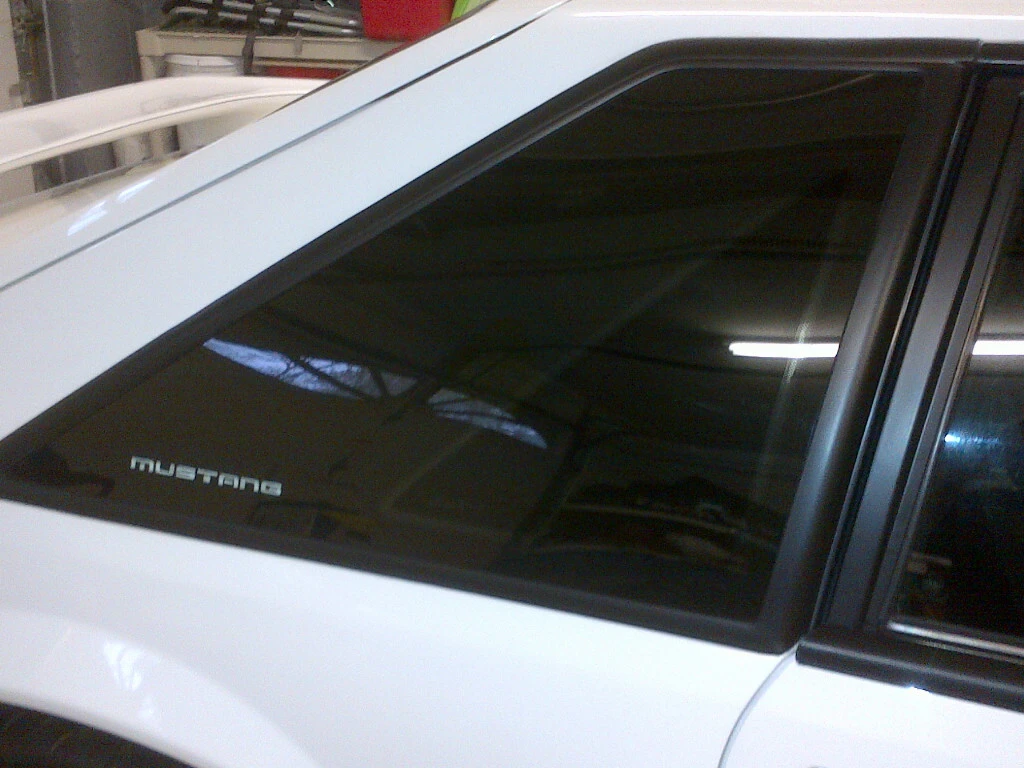

Nice work! looks cherry! I talked to my body guy today and he said they came out nice. He did the same thing and left them on the car. He also did the rear quarter window molding, sanded it down and filled in the few rub spots and repainted them. Ill throw some pics up when I get it back.

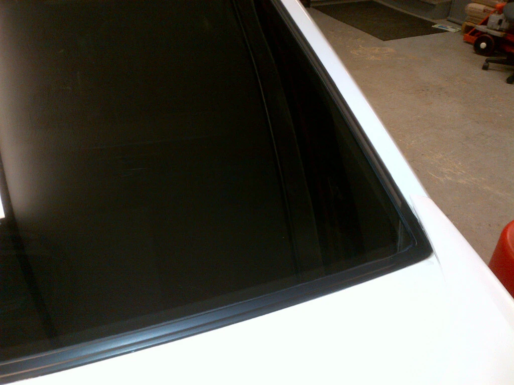

Here is the finished product! everything was left on and got taped off really well, came out pretty nice!
