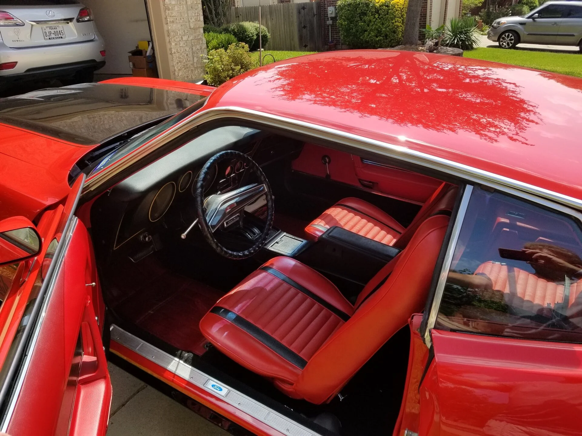

Have attached a picture of front interior and door panels.
Any suggestions.

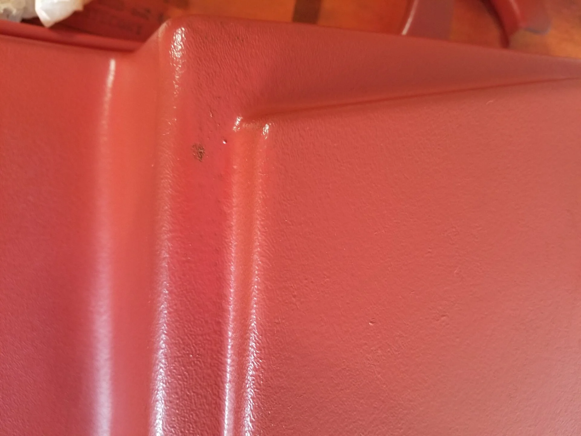

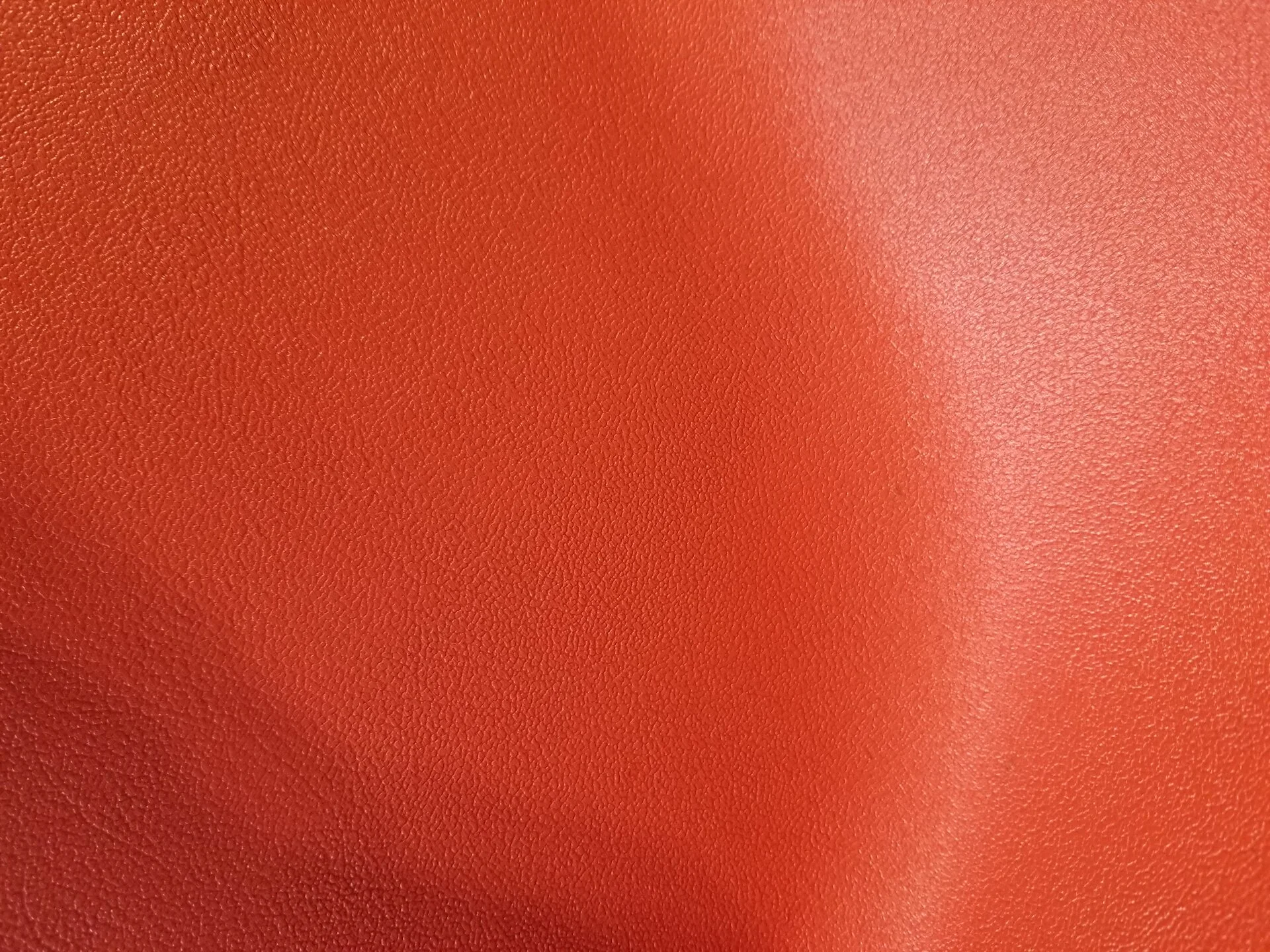

I purchased SEM vermillion red which is the interior color of my 71 Mach 1.
I sprayed on the adhesive promoter as directed and 4 coats of the SEM paint.
I ended up using the whole can and was disappointed in the coverage.
It did not cover very well. I have attached a couple of pictures. One is of a worn spot that is black that I even over sprayed (I have a few others but are out of site) as you can tell and the other is the main quarter panel that had sun damage. In person you can still see a hint of darkness.
I have a feeling if I buy new which all I have seen come black color it would not cover.
The paint cost around $18 and shipping $13.
Looking for suggestions on what I may have done wrong or if there is a color that is close. It is the back seat, so if close not to noticeable.

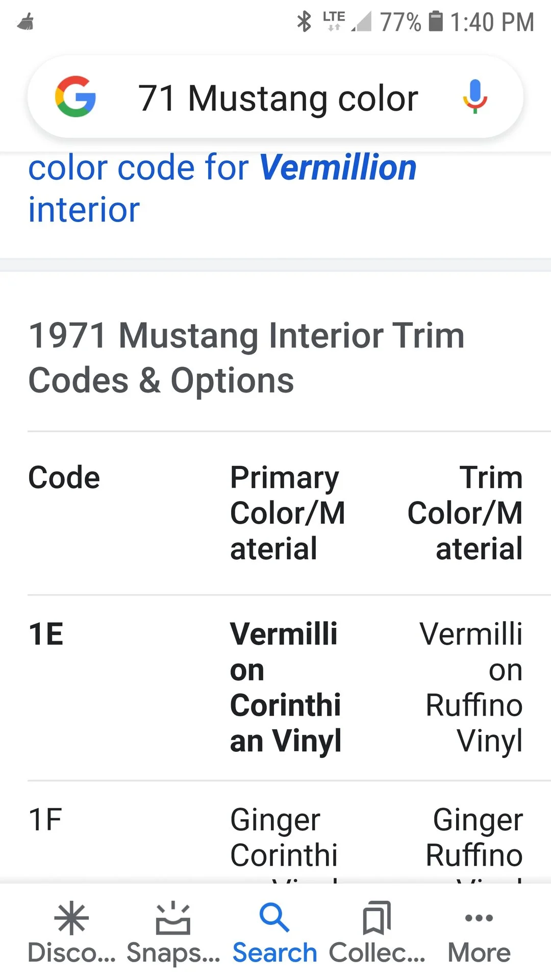

I am back again looking for paint help.
I have found a place that will make me a spray can with the color I need if I have the color code.
I have tried Ford but car is to old. I also do not have the sticker on the door. I know the exterior is Bright. I need the interior color code for Vermillion Red.
Any suggestions or answers appreciated.
