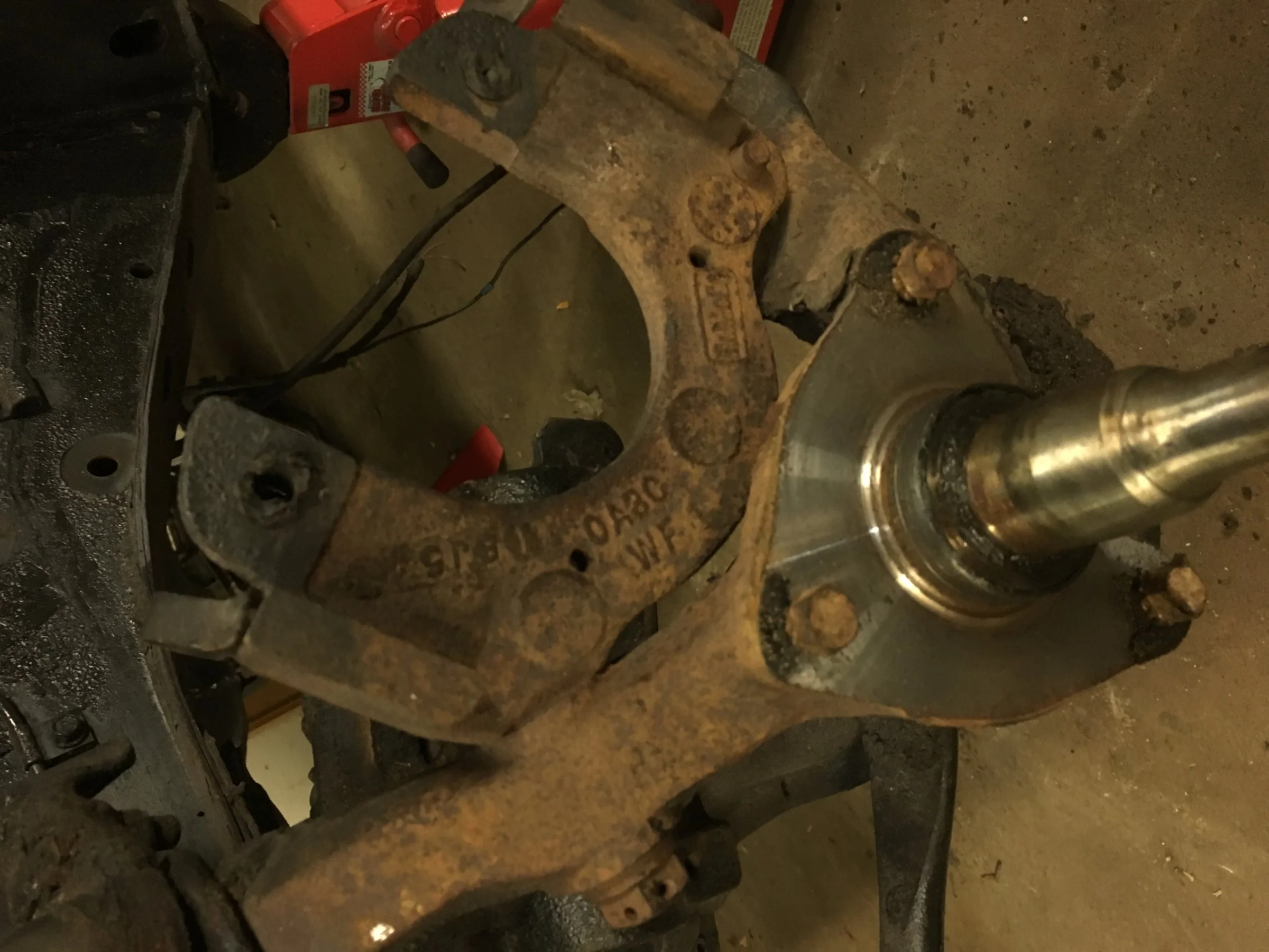

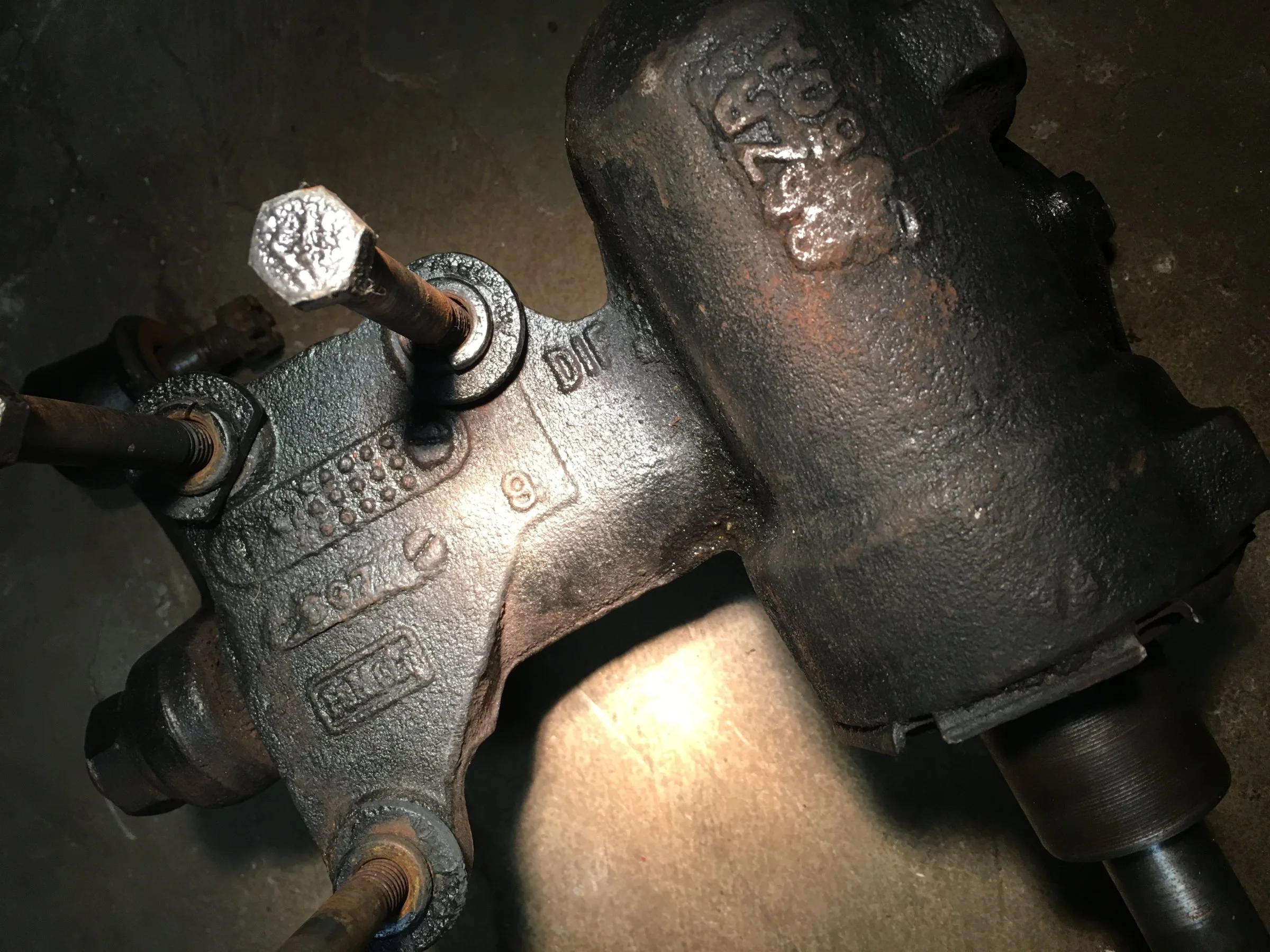

Can anyone help me in identifying the steering box and knuckle on my car and a recommend route for upgrades or best systems.

Look at the metal tag on top of the box ,the quick ratio box for 68 -70 is SMBK ,IF IT DOES NOT HAVE THAT CODE IS IS A SLOWER RATIO BOX . WHAT YEAR BOX IS THIS ,JUDGIN BY THE CALIPER IT IS 68 -70

Mine says 6HO2B so I’ll have to find a new one

Horse Sense was asking for the code on the tag. Normally it starts with H something - something or S something - something
Your 6H02B looks like a date code for 1966 August 02
