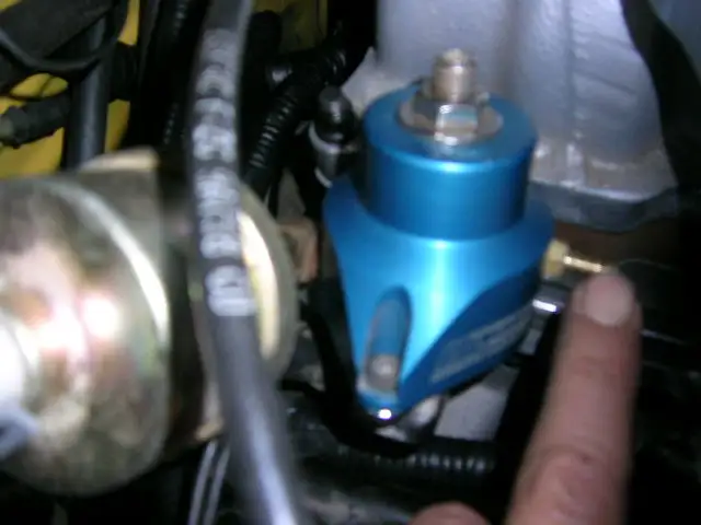

Y YELLOW 94 Founding Member Nov 19, 1999 428 0 17 Rio Rancho NM Mar 9, 2008 #1 Mar 9, 2008 #1 I have a Paxton adjustable fuel regulator and was wondering where the vacuum hose attaches to. Im almost ready to start the car after 6 years and am just making sure every thing is correct. Attachments DSCN2867.webp 12.7 KB · Views: 121
Rick 91GT Mustang Master Nov 29, 1999 9,692 95 99 PA Mar 9, 2008 #2 Mar 9, 2008 #2 Where your finger is pointing is correct, you should have a small maybe 1/8" to 3/16" I.D hose coming from the intake.
