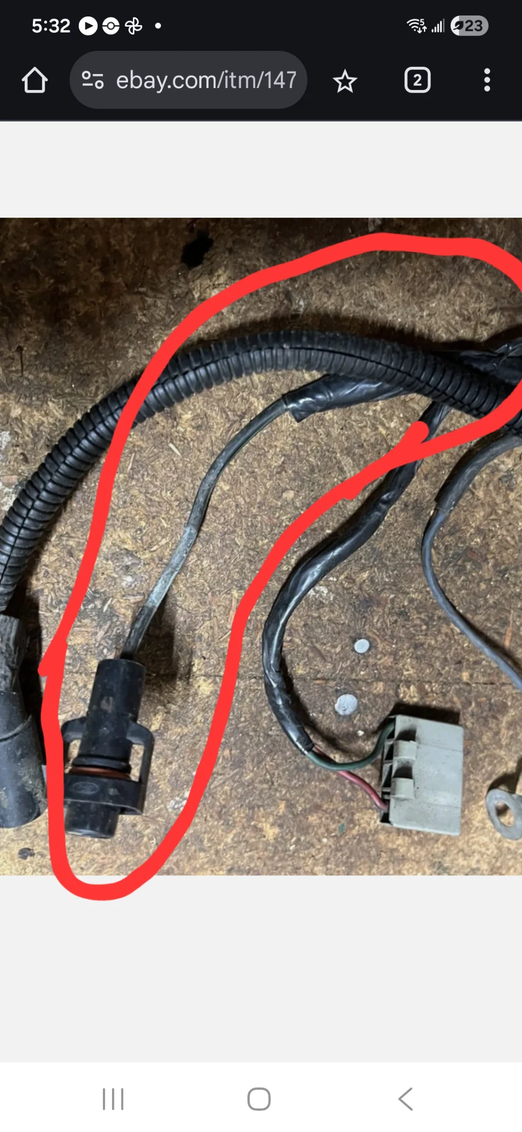

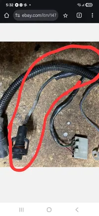

F fox1990 New Member Jan 10, 2026 2 0 1 Moreno Valley, CA, USA Jan 10, 2026 #1 Jan 10, 2026 #1 Im missing my connection for the pcm ground that connection the the negative battery seems to be cut off can I just splice the wires to The negative cable or do I have to Get the connector can some one help Attachments Screenshot_20260110_173206_Chrome.webp 203.2 KB · Views: 103
Mustang5L5 That is…until I whipped out my Bissell Mod Dude Feb 18, 2001 43,348 18,083 224 Massachusetts Jan 12, 2026 #2 Jan 12, 2026 #2 It actually connects to chassis ground, and the battery neg together, which is critical at preventing ground loops. Here's a repop cable, but you can replicate it as long as you connect it to both chassis and batt neg https://www.cjponyparts.com/battery-ground-cable-negative-with-computer-ground-quick-disconnect-mustang-1987-1993/p/BC26/?year=1993&msclkid=c12c23993a8a163249724afc244081da&utm_source=bing&utm_medium=cpc&utm_campaign=Core%20Vehicles%20Shopping%20(Tier%202)&utm_term=4583451683749158&utm_content=Core%20Vehicles%20Shopping%20(Tier%202)
