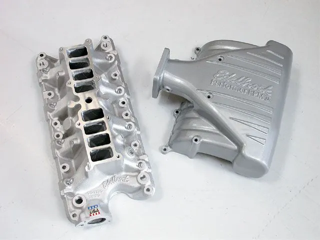

Performer 2 Upper Intake Removal.
Look at hte lower for the bolt locations on the upper. front one looks like a stud and four bolts down each side.
If i had to guess its the one on the back drivers side that youve missed, lots of wires back there to hide behind.
