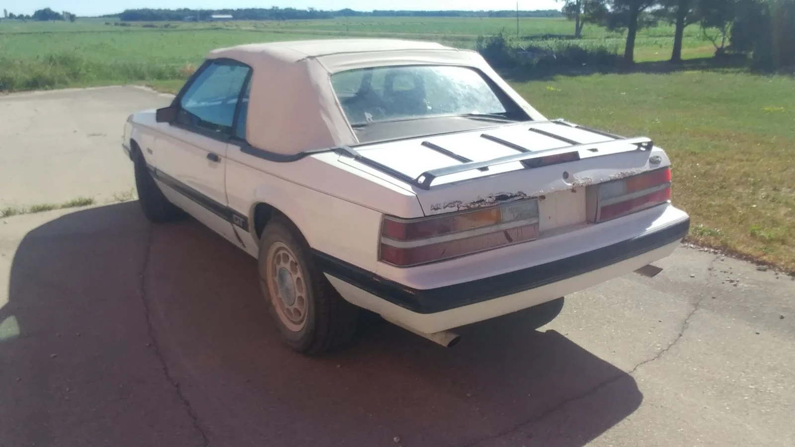

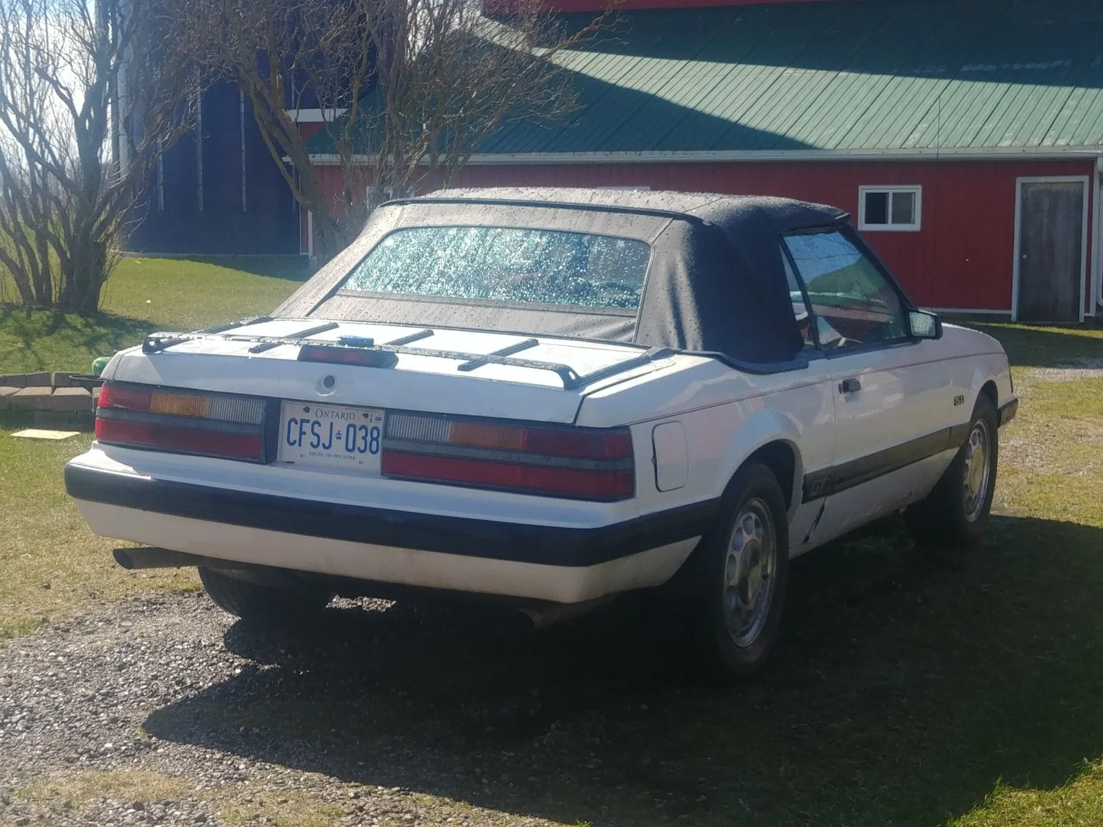

I did that job just last march. My big mistakes that made the job less than perfect are I didn't get the pocket seated properly in the sail panels and I didn't stretch it tight enough on the front bow. It is super difficult getting every last wrinkle out of those tops. And the 300 bolts behind the back seat that need to be torqued just right. What a crappy job!! I switched to black from the original white as can be seen before and after.

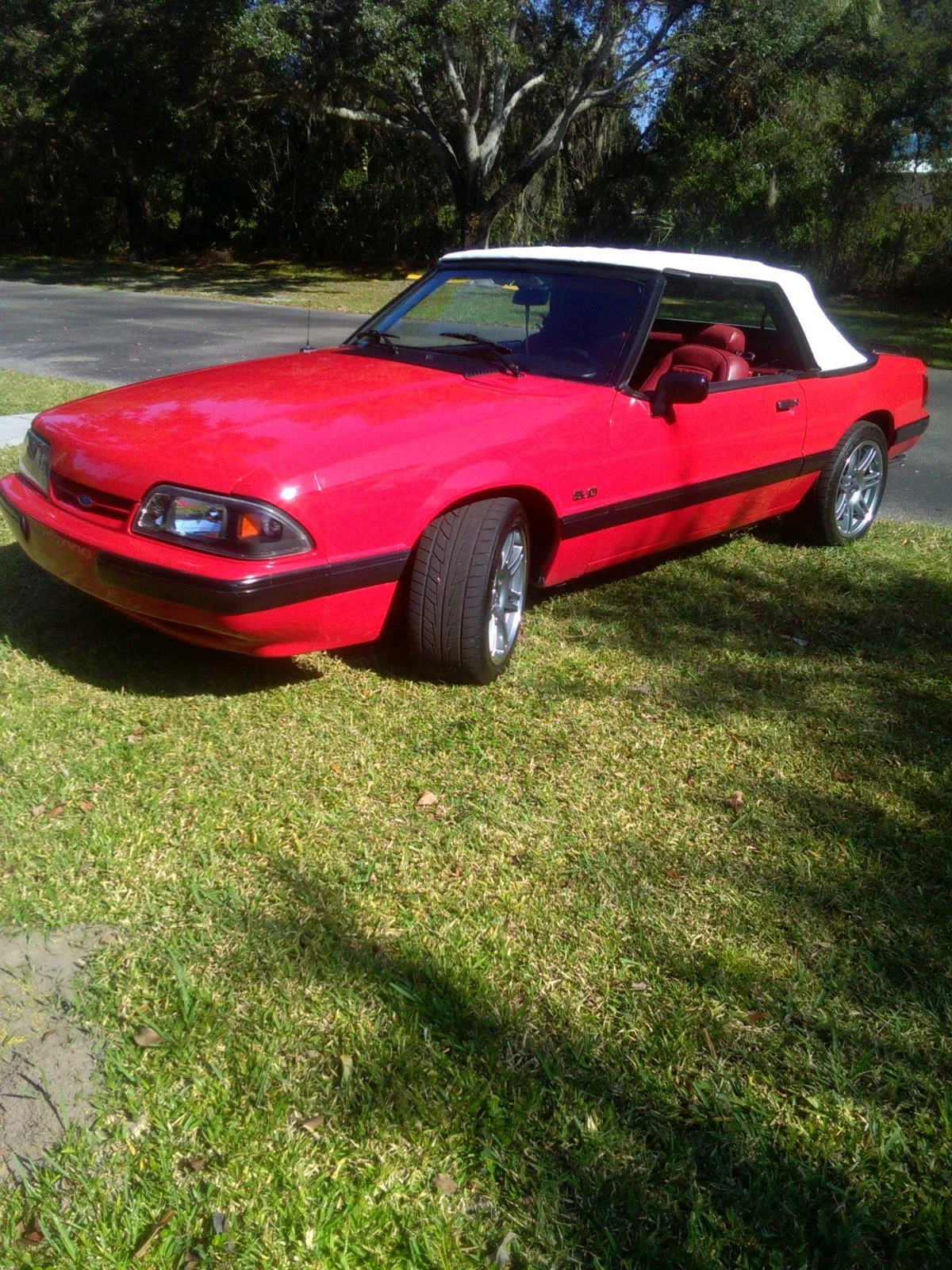

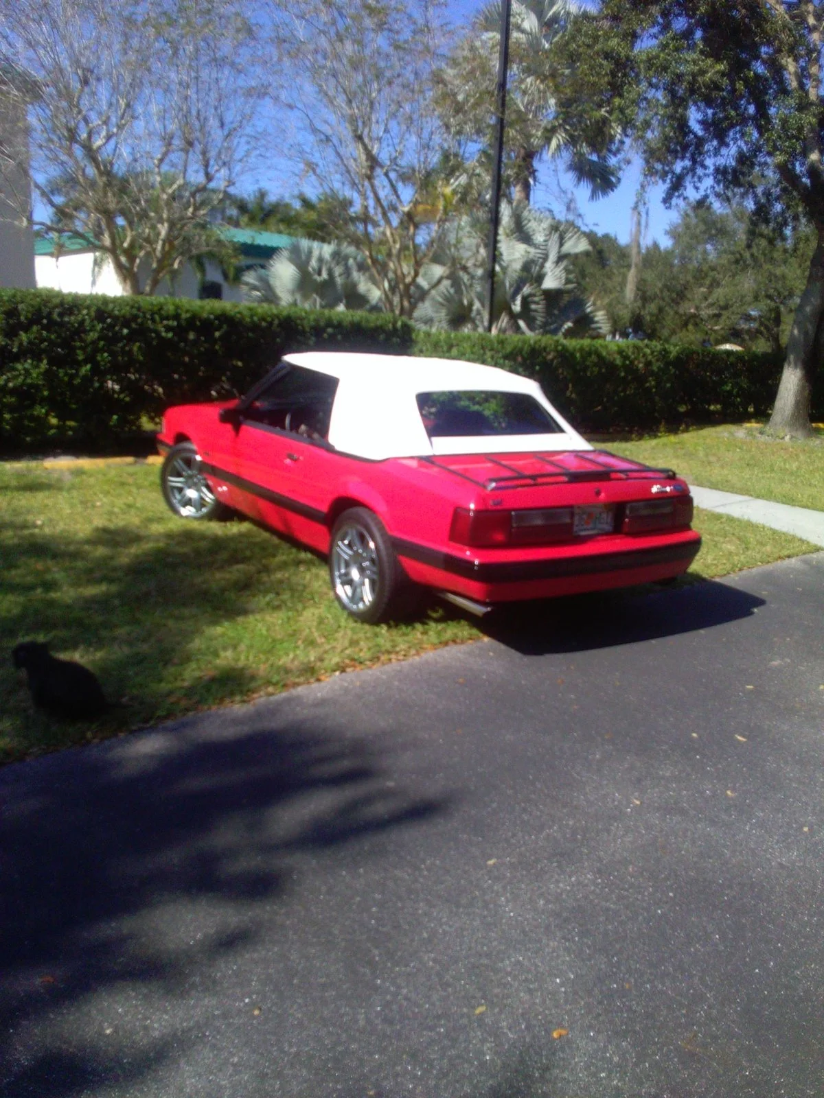

I am concerned about the finale pull. You have to put a box between the windshield and the top. About 18 inches , staple it up and close the top. This should all come together tight. We will see. I have to really see how much pull Im going to get. The more the better. I got the movie on how , but your still really on your own.
That final pull is where I kind of messed up - pull it as tight as you can, mark it with chalk or whatever and then add another half inch to an inch. One day I'll remove the weatherstrip and yank it a bit further but for now its functional. Good luck.
oh ya one final pointer on that final tug - not just tight but straight towards the windshield. If its crooked it wont cover as far down to the door windows as it should exposing some of the convertible framing
So you would say one inch maybe. Or three quarters. It needs to be tight. Iv been redoing if its not right. I think thats its going to have some small imperfections. Hopefully very small. Local price was $1600. 00 .Tops on line price $250.00. The name of the game is do it yourself. Now I need some plastic Equate cylinder heads.
Yeah go an inch, worst case scenario you can always relieve tension at the end below the window. This is definitely a case of you only get one shot if you trim too much excess material. Be careful here

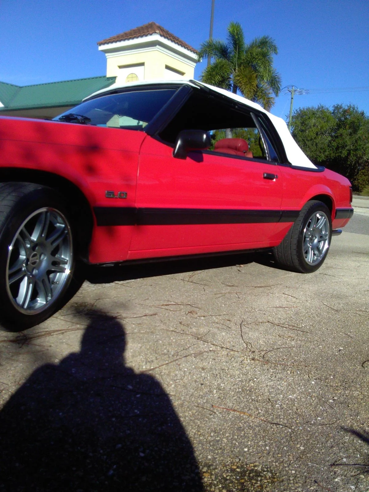

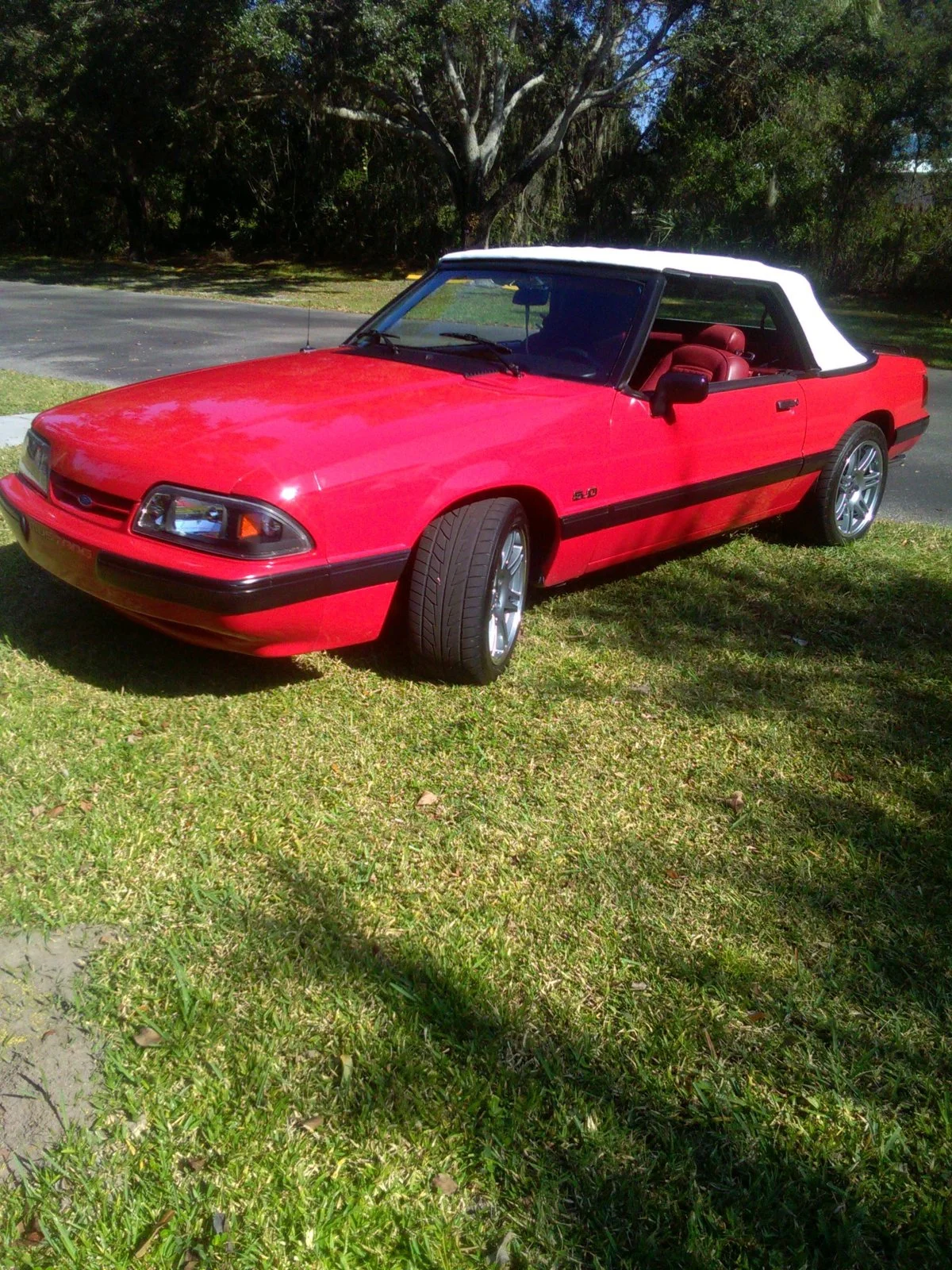

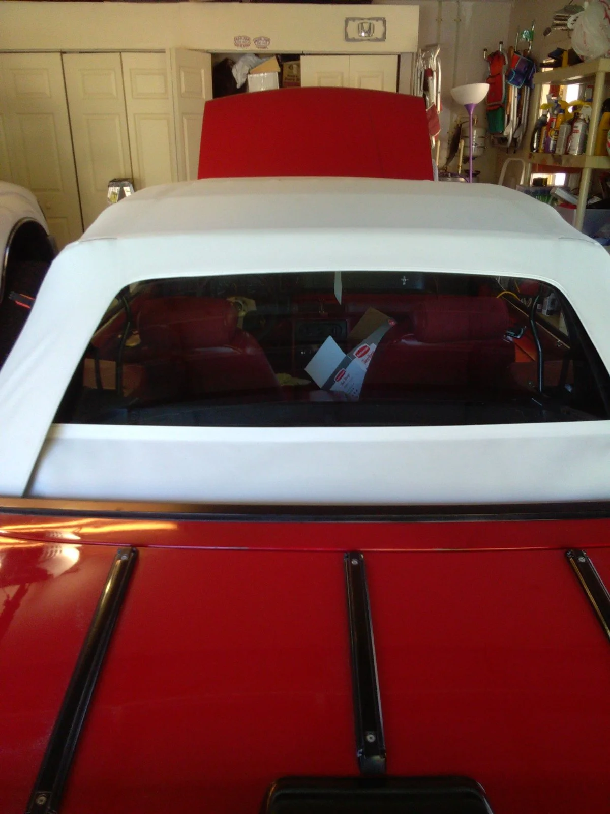

Almost done with the top. Waiting for the glue to dry on the header , and the sides. The secret on getting everything tight was to staple the header while its halfway up , .and really short it. Maybe a little more than an inch. Then close it. You gotta really push it down then latch it. I never thought it was going to get tight and crease free. Drives me crazy though , handprints and such are hard to get off. Still have to staple on the round canvas sealer in the front. And the classic thing across the back bow that has the stainless ends. I couldnt control myself because I hadnt driven in three weeks . So I went to the church for a dog walk, and some pics. A $250.00 mod that most convertible people could do.

It worked out real good . Mostly got lucky on some things. Worked each side well after your suggestion. Also really cut the top short at the header. Nice and tight with very minimal waves. Anybody should consider doing it themselves. If you fox is your hobby , then your obliged to do it yourself. Next is heads . Im thinking ProMaxx maybe. Something Iv never done before , and Im very nervous about . But read about over and over . I only have about eight hours in that top. Thanks for looking. Glad I have a foxbody , and you guys are great......
