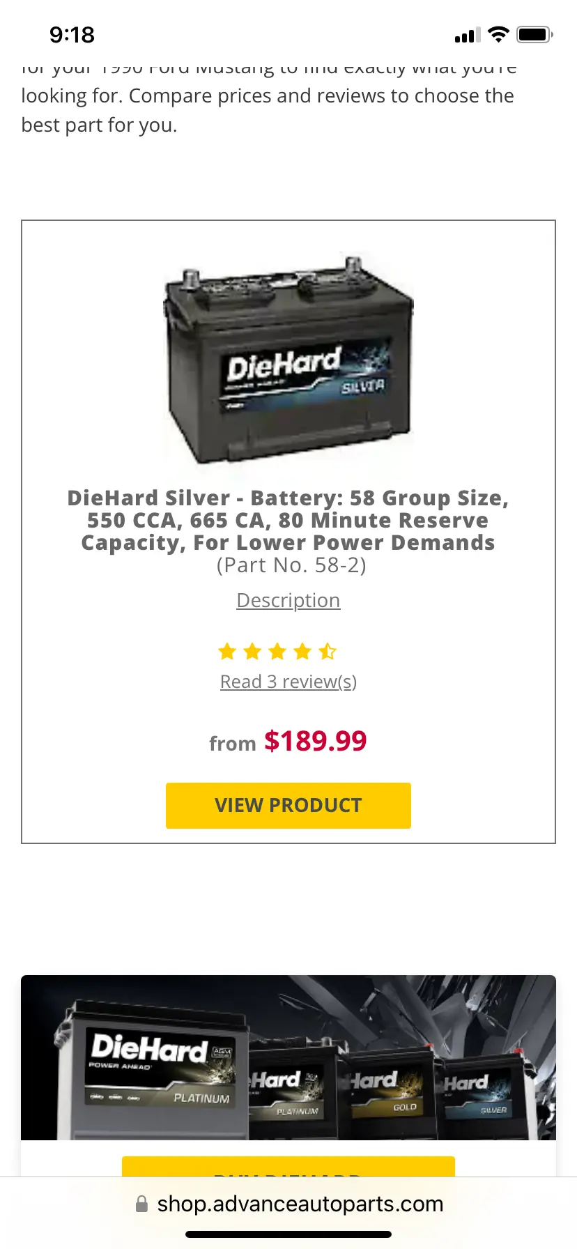

Do you have Advance Auto by you…. Found this die hard with a quick search.

I am trying to work around the $189 plus tax. I just lost about three grand on this Jeep and Im feeling a little wounded. Walmart has batteries at $109. I need to get two rims. I want the back ten inch for that staggered look, and I need four tires. Thats bout a quick grand plus. I also need to get a sleeve and new Rear Main Seal with possible clutch pad because its soaked in oil. I think Im paying to have that done because Im not into dropping the tranny on the garage floor. So Im going to give an estimate on a job then going to get a battery so I can get this thing out of the garage
Walmart two year 650 crankin group 24 I think. $109.00 I feel bad about not buying things at Advanced Auto, but online prices can cut them in half. This battery still has the positive lug within a range to touch the hood that Im not cool with.
A Group 24 battery is about 2 inches taller than the recommended (for your car) Group 58 battery. I could see where that might present a clearance problem. Why can't you use a Group 58 battery?

Group 58 is a battery that Walmart doesnt seem to cover anymore..The Group 24 is working out ok. The General set me strait. Im going back in and doing it right on the radio.. Back in the day I wouldnt be surprised if I had it wrong
