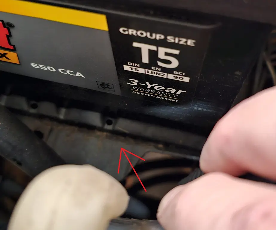

You can see here, where it doesn't fit the OEM battery tray:
The battery has a flange on both sides. It hooks right into the retainer on the fender side but is just a hair too wide to slip into the lip on the inboard side.
So. I will probably just trim this tray and put nut-plates under the holes you see in the battery flange and bolt it down with a thin strip of metal. Remember, it's already hooked under the lip on the fender side.

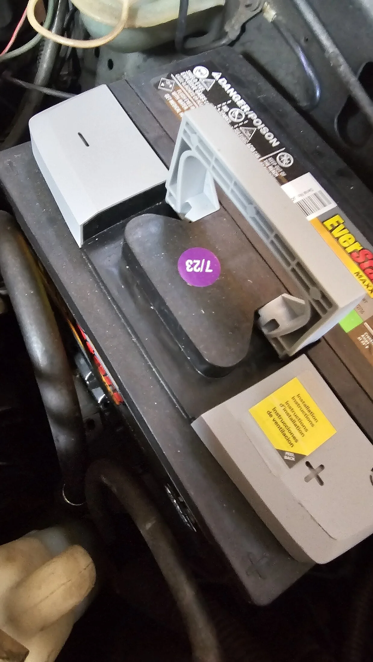

Oh, and I forgot....
Checkout the fold-down GoHandle and battery terminal covers it comes with.

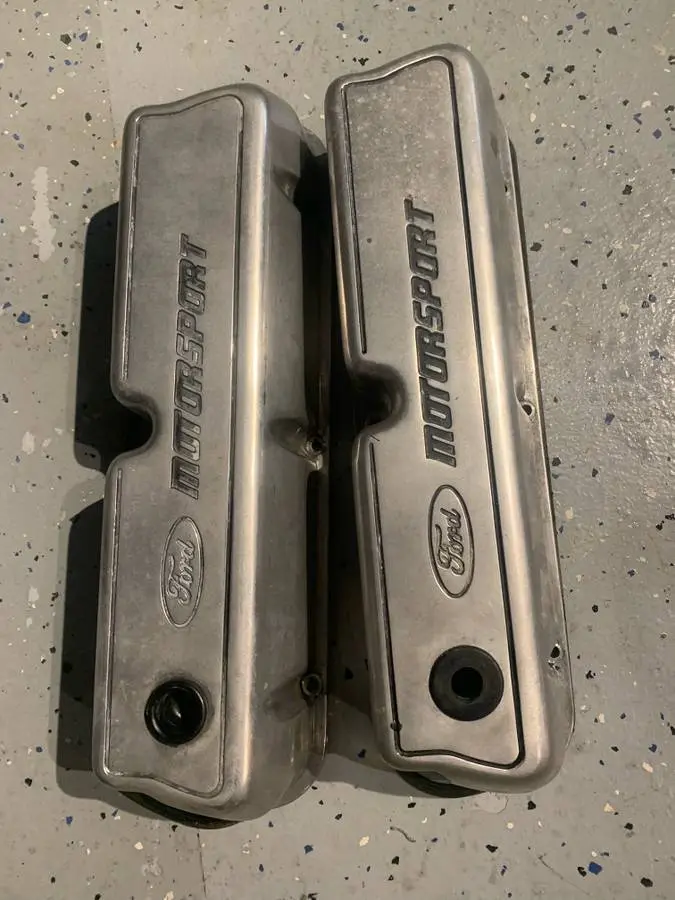

What do we think of these...$100.00 Craigslist He says they polish to a mirror finish

Unless your car is carbureted they won't fit under a stock style long runner efi intake

Thanks I really like them, but now I know. No garage relics

Are you trying to clear big rockers or are you just looking for a change?

The valve covers can work with an intake spacer etc . Guys have done it

I like the nostalgia of the valve covers. I like the old Motorsports

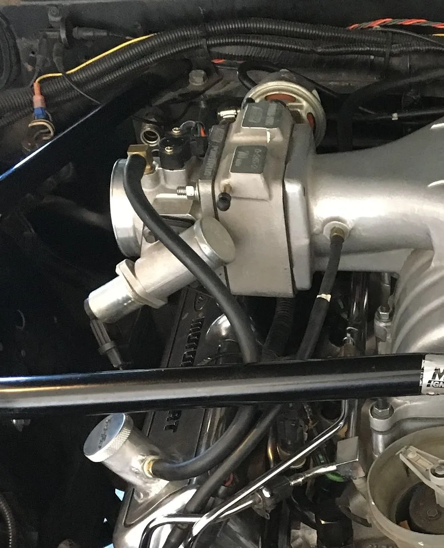

They clear with a 1" spacer on my Edelbrock Performer RPM II intakes. Needed the 1" spacer to clear the throttle body linkage over the top of the valve cover. Had a Trick Flow oil filler neck tig welded to the cover and then a 1/4" NPT aluminum bung welded to the side of the oil filler neck for the PCV system plumbing. Remember that the PCV system is a closed system so no breathers or air leaks. Best picture I have of it right now with the 1" aluminum spacer:
They go good with your look. Really nice.
