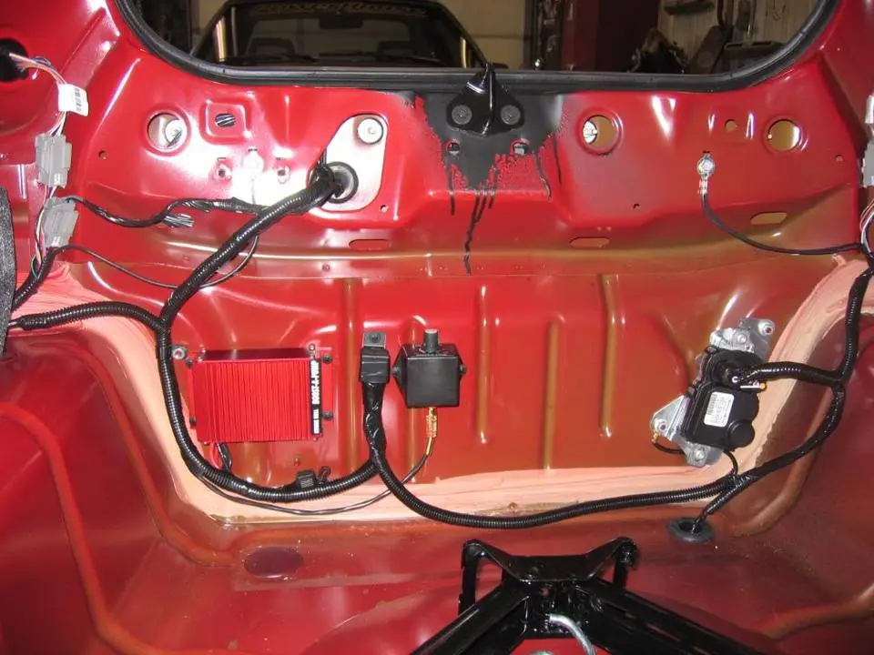

KB 40 amp boost-a-pump

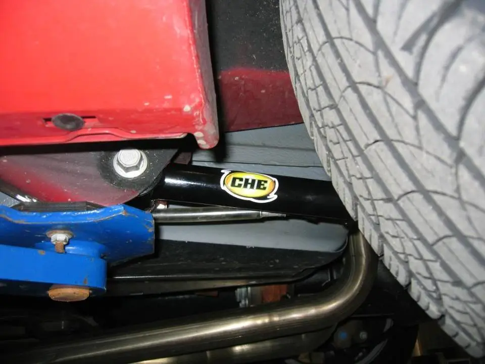

CHE fixed lower control arms

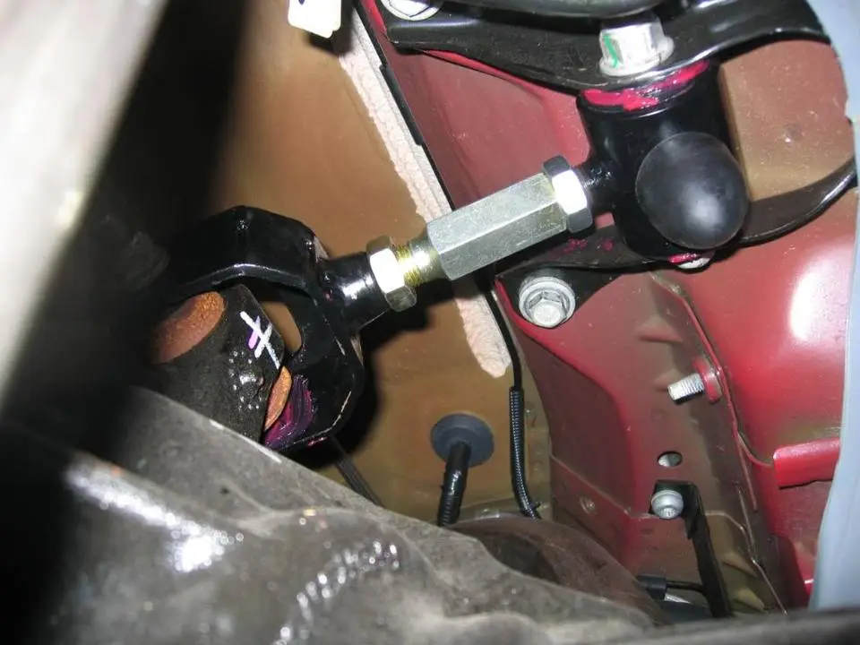

CHE adjustable upper

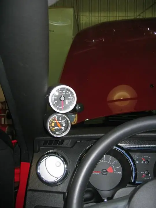

Dyno Jet Wide Band Commander, Auto Meter Boost gauge, Speed of Sound pillar pod (thanks for a great product at a great price Alan)

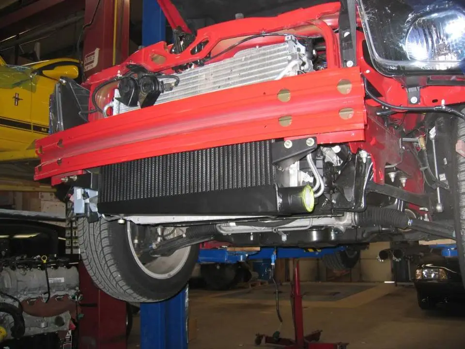

Good to see the fenders covored. Shows that PH looks out for their customer's cars.

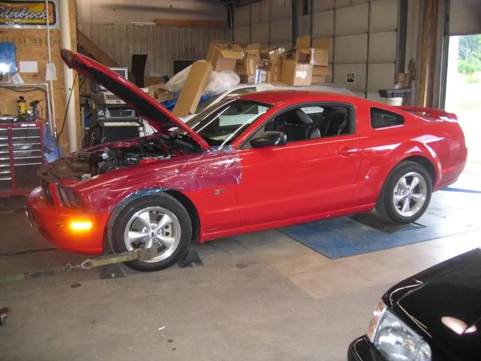

Well it came out the shop and the car drove 440 miles home with 0 problems The drive was well worth the outcome. Car drove like it was stock. Only 4,000 on the clock when I dropped it off!
It made 421RWHP & 416 RWTQ on a mustang dyno with crappy weather, rain and only saw 8.5 lbs.

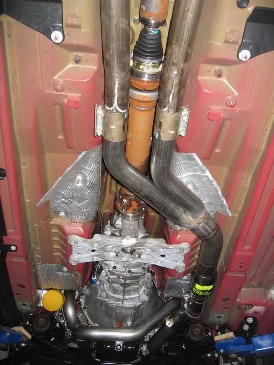

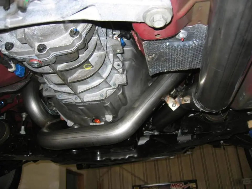

... that pipe under the trans. looks like it'd catch EVERYTHING...
Are you lowered? If so, how low? Have you noticed catching on speed bumps, etc...???
How far is it from the ground in inches?
I am curious if there is a clearance issue, or if it just 'looks' like there is, or would be, one.

No, stock height. It will clear everything like stock. Even when it's lowered. This is actually an issue I was concerned with and looked more into it before deciding what turbo to go with. Hellion has that issue.
A member from another forum emailed me pics of underneath his car while on the drive way. You wouldn't even know it has a turbo!!!
By the way, if you're looking at the pic of the lower control arm it's because the exhaust was not bolted on at the time. I don't know if that's the pic that raised your concern about clearance. It sure had me thinking for a bit till I figured it out lol
