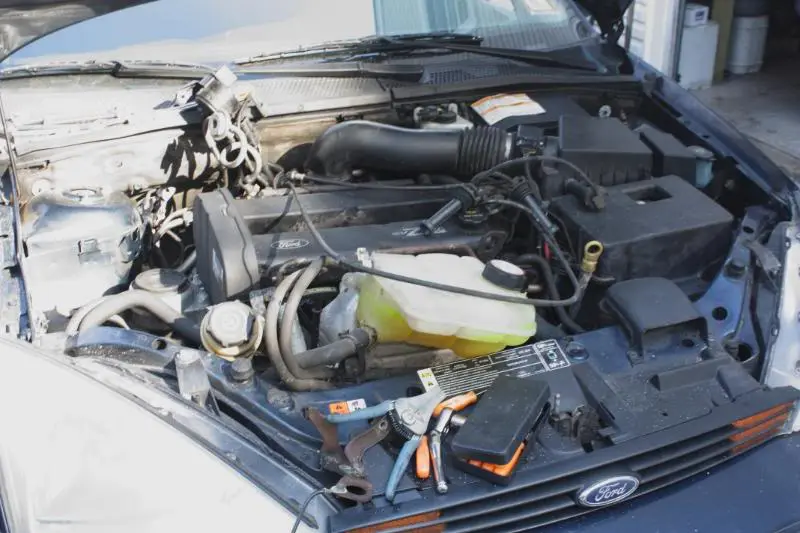

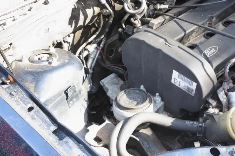

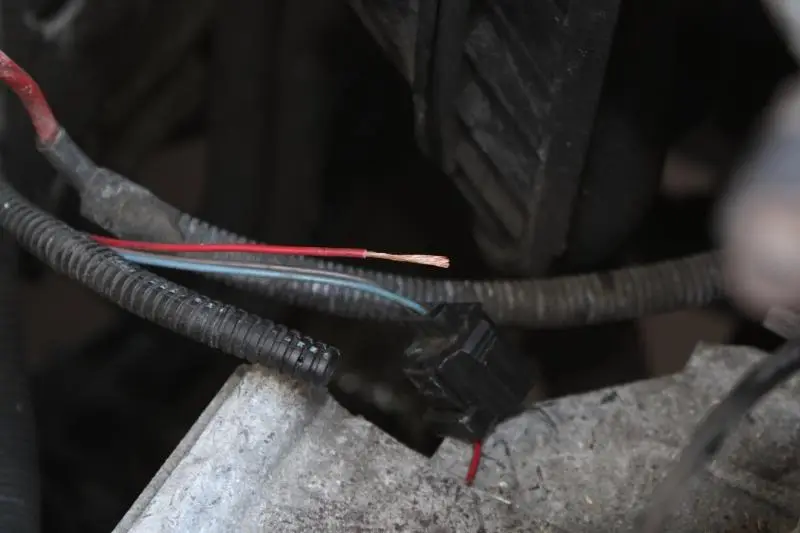

Yesterday. I picked up the VC gasket, Trans filter, and Alternator. and went up to work on the car with chris. The alternator was a total bitch and took all day... the engine needed to be lifted... so i had to undo the mount. also move the overflow for the coolant and the power steering as well as detach a few connectors and fuel lines... Then it finally came out... chris found a good way to pull it out. i did notice a broken wire on the connector for the alt... which had to be removed from the connector and soldered. Then i did the VC gasket and cleaned the engine with degreaseer.... and went on to detail the interior....

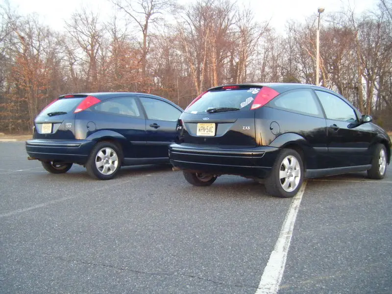

Today i washed it and mine and took some pics.

Doesent look half bad and rides like new

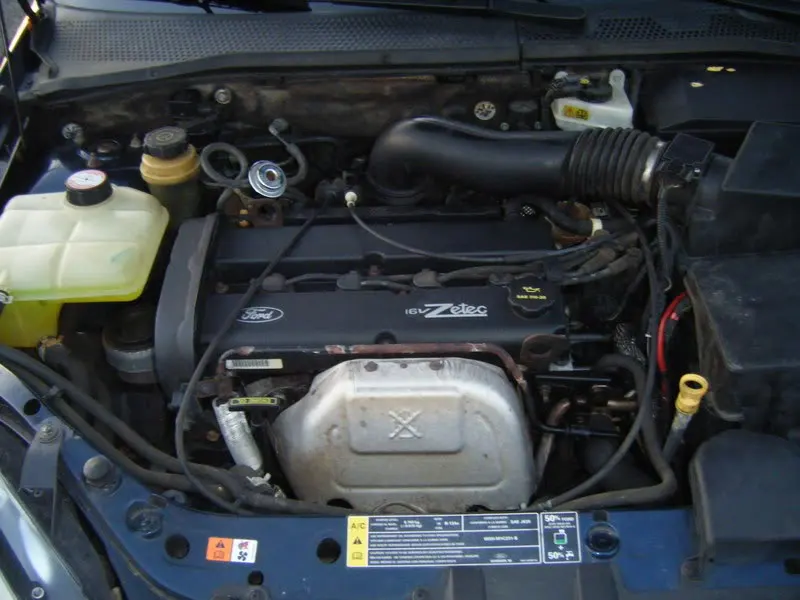

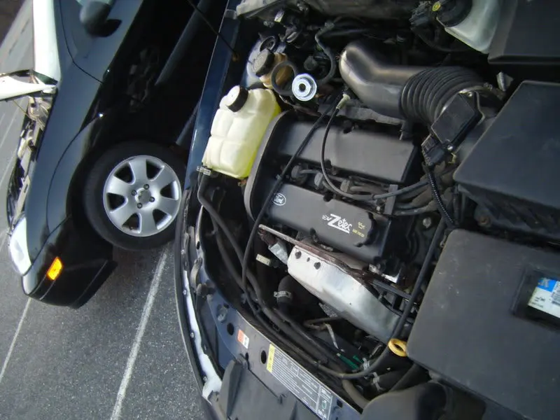

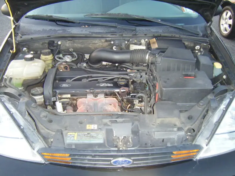

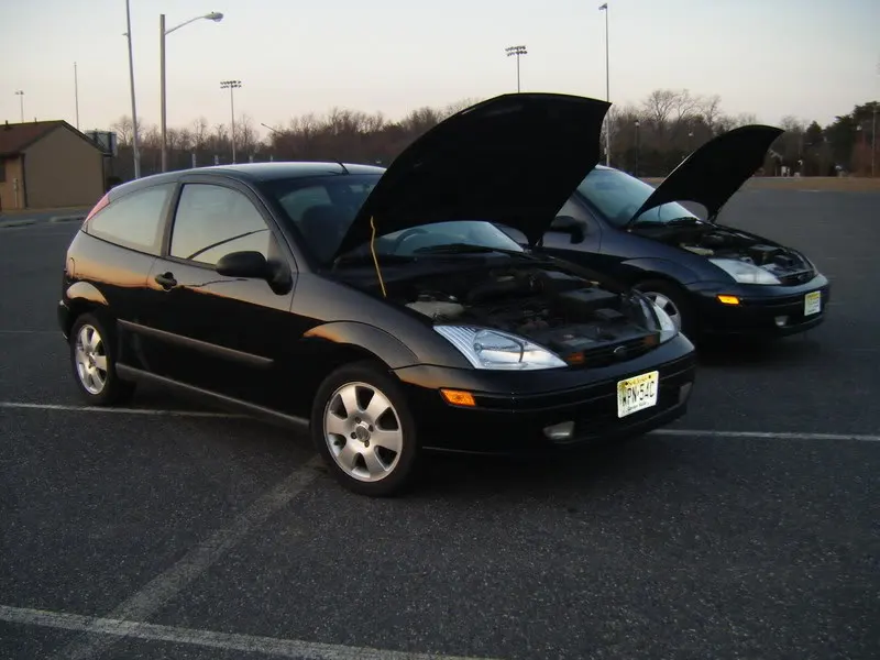

my bay:
Dirty

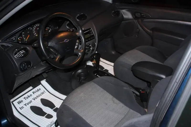

My interior:

Nice find. I'm sitting here in amazement that you too had the broken red wire on the alternator. Last month I was driving home from work and the little red dash light would come on, but it'd go off when I hit the throttle. It did this for about 10 miles then it went on and stayed on. I couldn't figure it out and thought the alternator went out. Luckily I got to looking around back there just to see if anything was loose first and I saw the wire. Ford sells the pigtail and I picked it up for roughly $35. I cut the old one off, installed the new one and left all of the extra wire length in tact so it'd never happen again. I think this was a design flaw from ford as the wire is pretty stretched to begin with and I think the constant rocking back and forth of the engine eventually pulls it out.

Yea... i already had the alt out... and didnt want to take the chance.... it was a complete pain... we used some picks and took the connector apart and rewired it up with some extensions.... i didnt really have the money... but i bought the alt/trans filter/ and VC gaskets for her set me back about $220 after core... but would rather have her driving a safe car.... she drives through some bad places (trenton) on the way to school... and when i turned the old alt.... it made a squeeky chirping noise.... :shrug: just didnt trust it....
