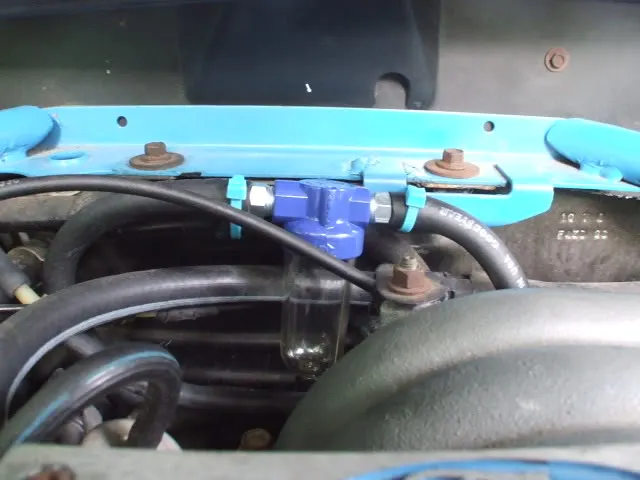

Pics of intake and oil seperater.
autozone sells them too. i made my whole thing for $20
Parts from Autozone; Campbell Hausfeld #MP5138...$11.99
#MP3314 3/8" hose repair kit...............................$ 3.99
#MP3207 3/8" hose end......................................$ 1.99
3' of 3/8" fuel line hose 1.18 a foot.......................$ 3.54
Almost exactly how I have mine mounted. Except mines a little over. Before I left it just kind of sitting there but sometimes it would go horizontal and I was worried about it not pulling oil down. So on the plastic cowl I drilled 2 holes and made a zip tie loop and now that holds the bottle. Works great!
