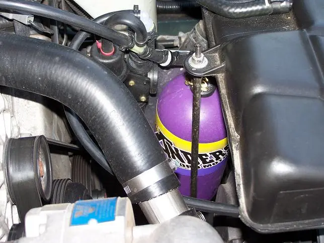

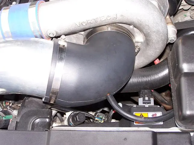

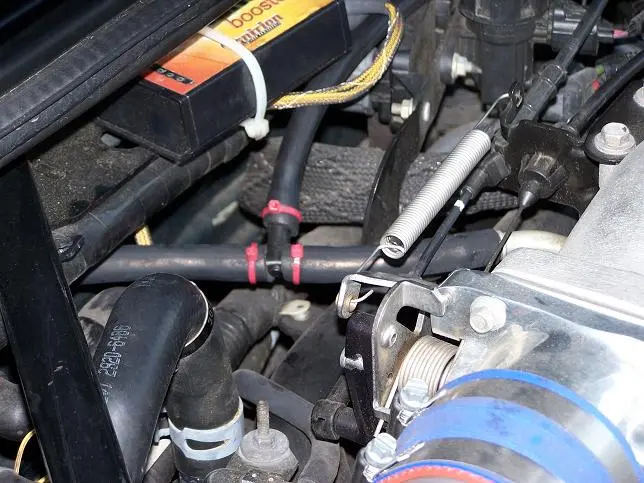

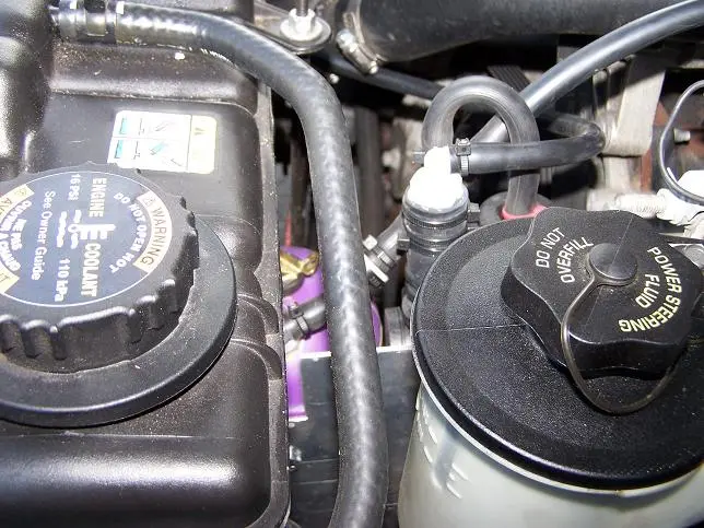

Mr.freeze is a water/methanol injection kit for supercharged or turbocharged cars which greatly reduces intake temps so you can run more timing and make more safe horsepower.
With the amount of air rushing through the supercharger at 50,000 rpms, the mist of water and meth should not hurt anything. I have to admit I havn't been running it that long to claim ultimate reliability, but I am not worried about it. Mr.freeze does not use that much fluid at only 10lbs of boost anyway. It might use a cup of water/meth mix in 4 or 5 blasts up the street. If you are concerned, don't try it. Wait for crazy people like me to let you know how long the supercharger will last with water and meth spraying on the impeller. For me, the gains outweigh the risks. I'll let people know if I develop any problems but I don't see how its gonna damage anything for a long long time. The only thing I was ever worried about was the chemical reaction of the meth to the aluminum impeller but so far so good. Use the snow kit and have peace of mind if you have the extra cash and patience for the install.
