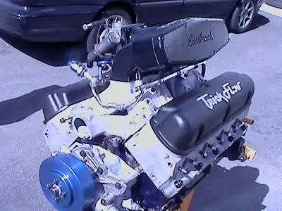

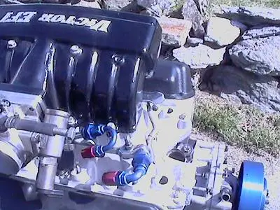

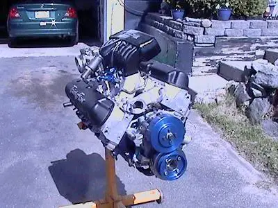

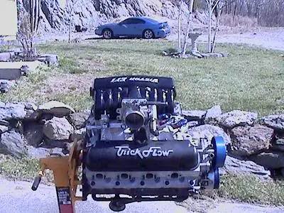

Pics of the new motor!!!
I finally got most of the motor together and I'm getting ready to put it back into the car. I took a couple of pics in the mean time.

Looking good! Looks similar to my combo.
Whats the rpm band on the cam? Mines 3200-6400. Are you running a 2.5" or 3" VRS X pipe? Make sure you open up the restrictive BBK collector, it necks down to near 2.25" :eek: Hows that VRS X pipe look over all? I'm going to be ordering a 3" X from them for my car.
Thanks for the comments. As for changing the oil, I drilled a hole in the top of one of the valve covers and I'm not sure on what to do after that...I was thinking of welding a 2" tube on the top of the hole and capping it. As for the specs on the motor, I don't want to spin it past 6000...The cam's rpm band is 2800 to 5800 so much higher would be pointless...I got a 2.5" VRS and it doesnt look like it was very good quality. It comes uncoated. But, it looks like it will work. How would I open up the BBK collector?
Use a die grinder or a dremel with a grinding bit on it. If you look at the collector you'll see how much is necks down. Definatly too small! I opened mine up to appx 2.75", but when I get the 3" X pipe, i'll get it as close to 3" as I can.
Why did you pick a Victor EFI manifold if you didn't want to shift it higher than stock? I use a TFS R and shift at 6,700.
I was wondering the same thing? If you wanted a 6000rpm shift point there are much better suited intakes than the Victor for that combo.
