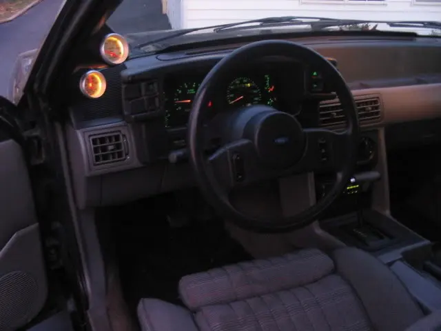

pics of the stang.

Thats pointless. You should get a boost gauge...then some boost to back it up! :D :nice:
:scratch: not really. the stock gauges are not accurate at all bud. boost down the road. i want to get my cam in and buy a set of heads, then get parts to swap to a 5 speed then ill stat collecting parts to either turbo it or supercharge it.

yeah ryan, those aftermarket gauges are pointless, get a "TPS adjustment sensor" and "chrome" those tail light bezels immediately :rolleyes:

So the gauges in the dash don't work anymore?
usually what happens in these cars, and the aftermarket senders fit where the stockers go, thus upgrading gauges makes the stock ones dead. i know when i bought mine the stock water temp gauge was dead, my old lx was the same way. the autometer i got is way more accurate anyway.

Get a T fitting for the oil pressure sender and hook your stock gauge back up. I also like having Autometer gauges that give you a real reading. But I like having the stock one work too. I think you could get more out of that combo. 25th made 272 with his set up if I recall correctly. Either way, car looks awesome. Your doing some really nice well done mods to that thing!!
