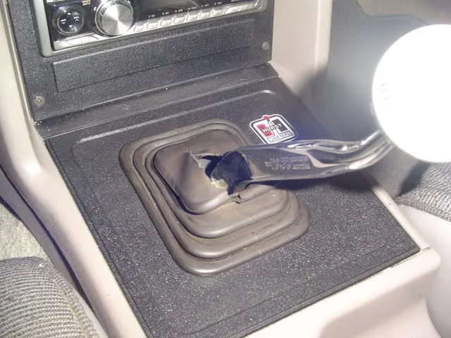

Was hoping to see if anyone has used the hurst chrome shifter stick and hurst rubber boot on there 87-93.
Like this one.
http://www.brothersperformance.com/catalog/product_info.php/products_id/4170
Was wondering how it looks, meaning is it a neat install with the factory trim piece or do you take that out and just use the rubber?
Don't want to buy it it it really does look good when installed.
Love the classic look thought...
thanks

I have it and it looks great when it's new. It looks like the boot and shifter came on the car from the factory. After a year or so the rubber boot cracks up and it's junk.

So how does the hurst boot attach to the trim?
Do you remove the factory boot from the trim piece??
How does the hurst rubber attach to the the trim piece?
thanks

It comes attached to the trim. There are 4 small retainers that hold the boot to the trim. You just pull your old trim and boot off, do a little minor trimming with a hacksaw blade and then the Hurst trim and boot snap into place. The factory boot does not fit the Hurst shifter or Hurst trim.

So the hurst boot isn't all rubber as it looks, its got a plastic trim piece under it that snaps into the stock holes?
thanks

I've had one in my fox for 4 years now , no rips or cracks like in pic , was a very easy and no mod reqiured to install , a little pricey but I like the old school look !!

The whole square plastic piece come out with the stock shifter boot. The Hurst shifter boot and trim go in it's place. Just like is pictured here.

I know the stock trim is attached to the stock shifter boot.
I just thought the hurst boot was just a floppy piece of rubber that just layed there.
Didn't know it had a rigid piece of plastic under it that clips in place.
OOOOOOO
I'm getting me one of these....
