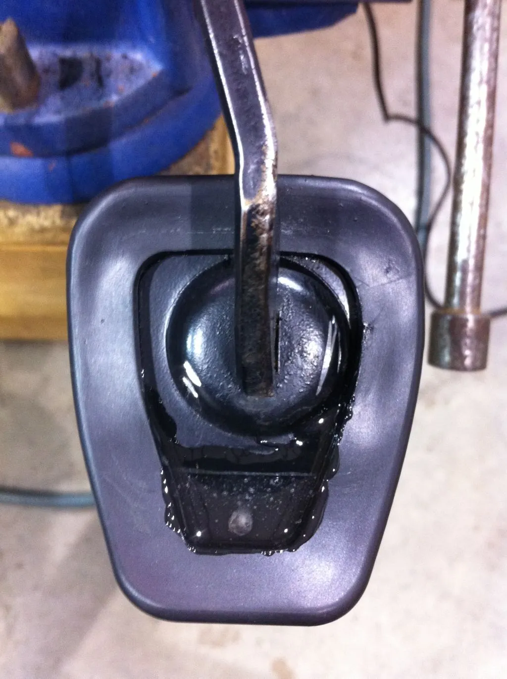

On a side note.....what pedal covers are on that thing Mike? The ones the guy put on my car before I got it are too wide for my fat feet. I end up stabbing the accelerator pedal when I go for the brake. Those ones seem sleeker and narrower?
Brian,
I used 2010 pedals. Because the dash was out I was able to remove the pedal arms and then I had to grind down the corners of the pedals to make the correct shape, I then slipped on the pedals and then used some epoxy at the bottoms to hold the pedals in place. It may be possible to remove them with the dash in but probably will require some cursing.
