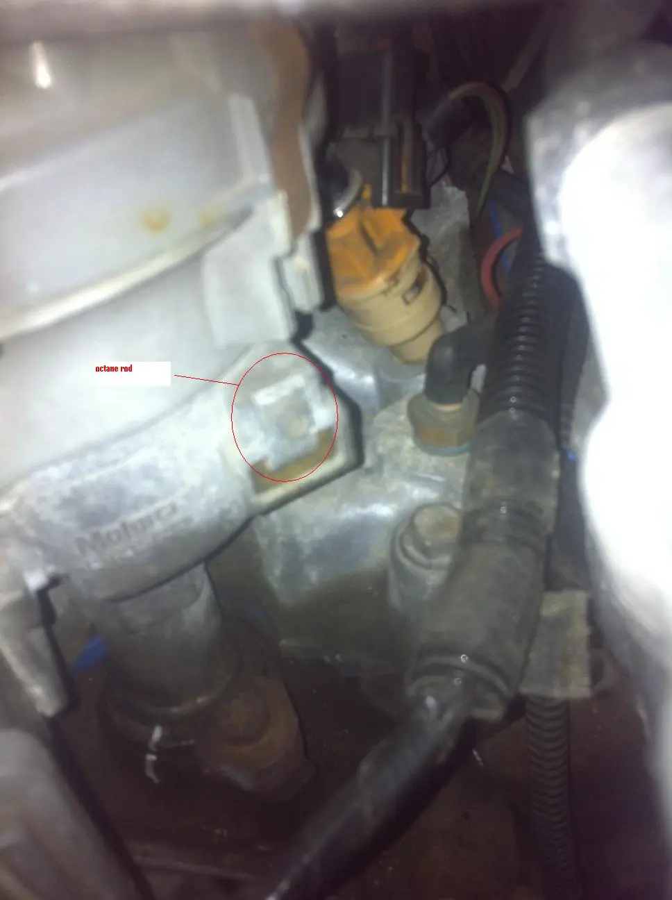

There is a thing in these distributors called a ping rod or octane rod that some how affects timing. I can't remember their exact purpose maybe some one will chime in. Anyway is this a replacement distributor? I'm still scratching my head....... With the time light on it what does it read if you crack the throttle off idle a bit? Is your damper new? I've seen the outer ring (has the timing scale) migrate away from its original position thus displaying incorrect timing when shot with the light. Try retarding to 6*btdc without spout just for to see what happens.

Mustang distributors don't have octane rods? Mine does. Everyone I have owned does including my current 91 lx. Will post picture when I'm at the PC next. I think there even is a tsb describing why just changing initial timing by twisting distributor is different then installing the proper octane rod. To the OP try retarding then test drive. A -*3 octane rod may help your problem. Maybe not though.

Here is a pic of my dist with an octane rod installed. See the screw I circled, it retains an L shaped piece of flat stock that orients the pickup in relation to the distributor body. Any way its prob not your problem unless you have a heavily modified engine or a distributor from another application.

My apologies, I checked the Ford Factory service manual, and there is an "octane rod". The mysterious "octane rod" is just metal bracket that locks the position of the Hall effect sensor so that it does not move and change the base timing. If you were to use a longer or shorter "octane rod", it would change the ignition timing without losening the distributor and moving it. The "octane rod" becomes a non issue once you loosen the distributor and use a timing light to set the timing.
