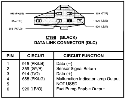

Is the fuel pump relay good?
Pin 6 on the test connector connects to the fuel pump relay and pin 22 on the ECU. Ground it and fuel pump should run.
Question then remains is the ECU outputting on pin 22 to turn the pump on?
Are you able to dump codes from the ECU? Would be a good indicator that the ECU is working, or not
