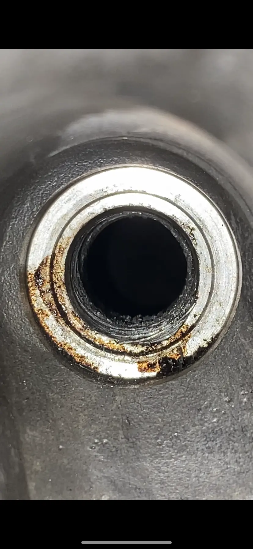

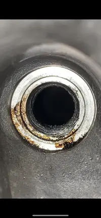

Hey i pulled the codes and i got code P0452 Evap pressure sensor, Also i installed the new spark plugs the old spark plug wires and spark plugs were on there since i bought the car it sat there for about 3 years at a lot around the corner and when i bought the car it hesistated alot so i bought a knew coil and spark plug wires and spark plugs but now it doesn’t hesitate it more so makes a putting noise the old spark plugs were brown when i took them out ( before the old spark plugs were removed my car never did the putting noise it does now in idle or driving but 1 of my spark plugs are so hard to put in all the way ive broke 3 spark plugs and just got this one 80% in i took pictures of the hole where my spark plug is supposed to go to see what condition its in and its chipped so its SUPER hard to put a knew spark plug in all the way
