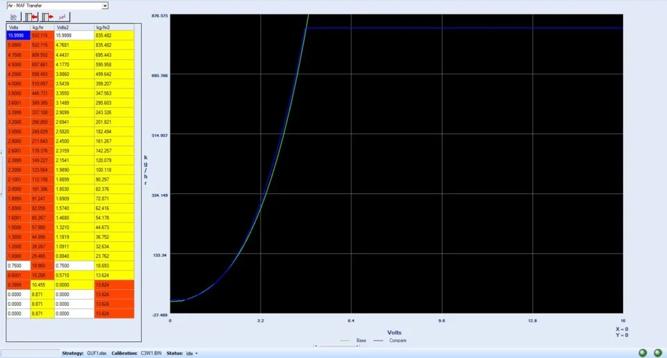

In this thumbnail, you will see a comparison between the T4M0 (94-95 GT) MAF curve (green line, orange values) VS the C3W1 maf curve (blue line, yellow values).
The curves are very close to each other throughout the voltage range. While it is not an ideal swap, it can work well enough to drive the car.
Your issue lies in the fact that you are still calibrated for 19lb injectors, as well as still being calibrated for a 302, not 351w.
