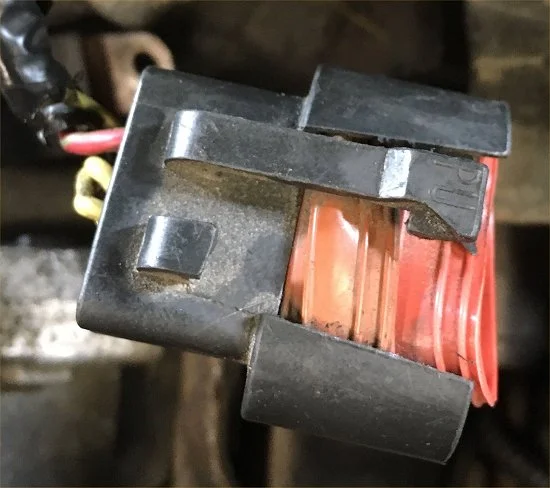

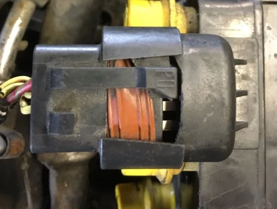

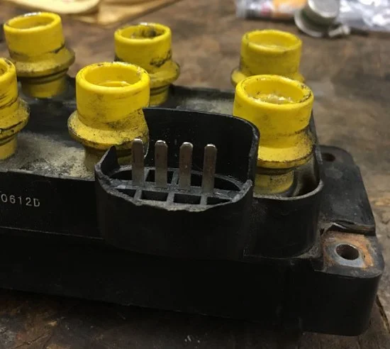

Well I remove the coil pack. I couldn't find the cracks but I don't think that matters.
That 4 prong connector that plugs on to it, it's broken.
I can put some pictures up on my photo bucket later tonight but it's missing a piece half way around on the cool pack connection of the plug.
But also the connector that plugs on to it is broken also.
So I don't know if moisture getting into that for 4 prong connector can cause a misfire?? I don't know what that connector really is.
I see Advance Auto sells the new connector and of course the coil pack.
The only difference I see is the Colors are different on the wires as opposed to my car. So I guess I'll have to just be cautious while rewiring the connector. I'm just guessing that's what the issue is.
Just trying to verify if moisture gets in at four prong connector can cause misfiring?
It can definitely cause misfiring. On the coil pack there are basically 3 twin coils that fire at the same time. So the 4-wire plug is one hot (+) wire and 3 negatives. Basically like 3 old fashioned coils mashed together. Any moisture in there can cause a cross-fire or a failure of the energizing power for one or more coil-sets to go straight to ground.

Thank you for the help. I didn't know if that plug could cause misfiring or not. I did see it had a rubber ring, like as for sealing it. So I figured it didn't like dampness.
But you just verified my issue, at least I know what my problem is now.
My car connector has 3 yellow wires and one purple, the aftermarket connector has one red and three black. I guess if I have the plugs faced the same way, I can just match the order of the wires to connect them. Did that make sense? LOL
For your entertainment, heres the photos. I feel stupid, but I wasn't sure if that could cause a misfiring so horrible!
Soon as I sprayed the top of the pack, if felt like a high lift cam. Without the fun!! Someone truly hacked when working on this car. People amaze me!
