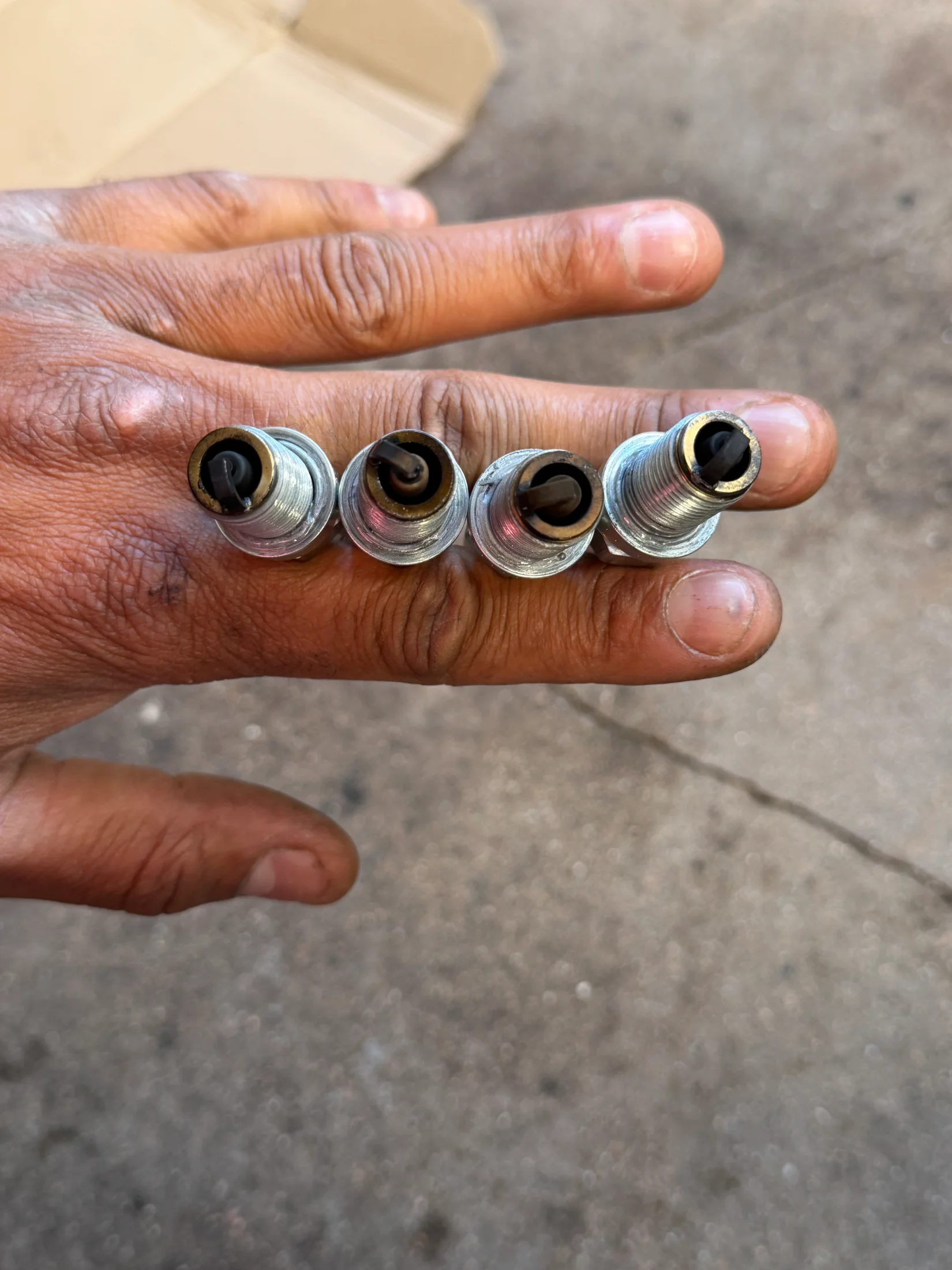

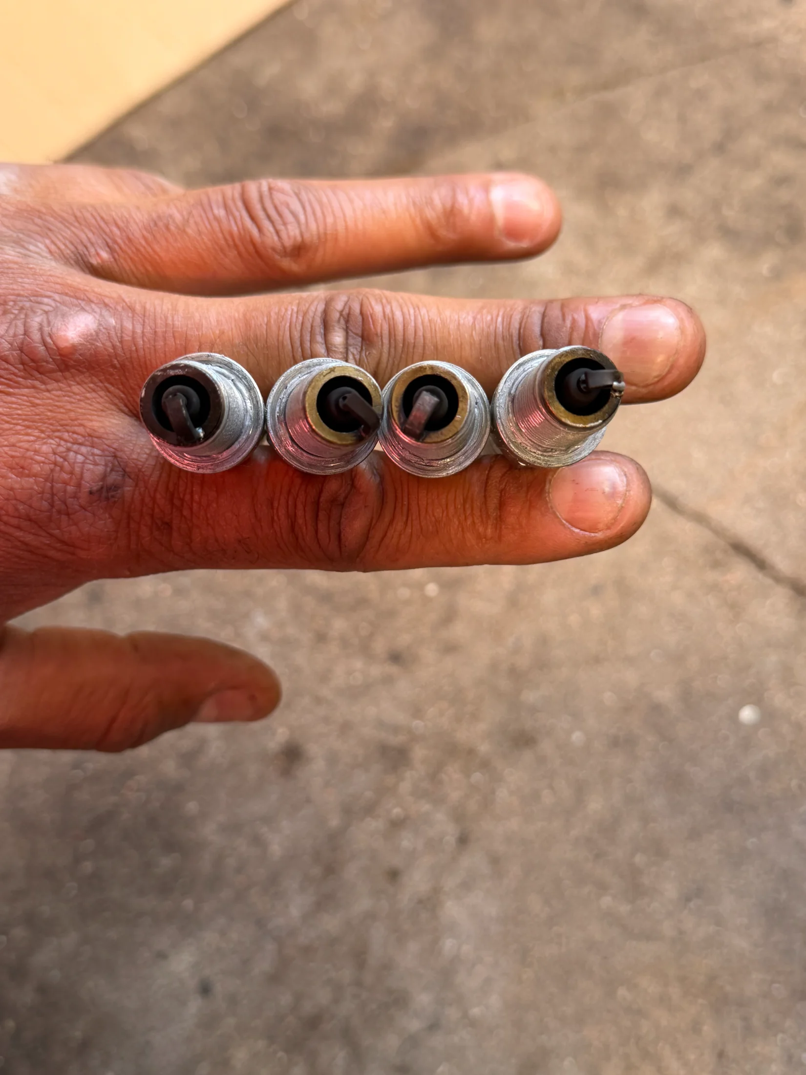

Removed & checked plugs (see below, 1st pic is bank 1, 2nd is bank 2, each bank is in order : 1234, 5678)
