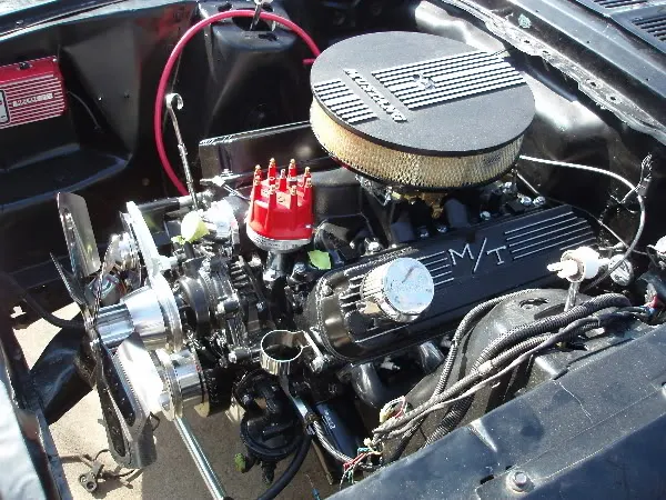

71, 302 30 over, flat top forged pistons with valve reliefs, wind age tray, 65 289 53cc heads screw in studs ported, polished, with 195 in 160 exh valves, beehive springs, 1.6 roller rockers, Wiend stealth intake, Lunati Voodoo cam Duration 262/268, Lift .499/.522., 600 cfm vacuum sec Holley, 3/4 length ceramic coated headers, sfi dampener, March under drive pulley's, MSD pro billet Dist 9mm ford racing wires, blaster 3 coil MSD 6al box, Northern alum rad Spal electric fan. Also motor has been balanced deburred and all ARP fasteners
I am not sure what it is going to make I will lose some due to my AOD but I do have a 2600 stall and 380 gears in the 9. I just wanted a fun driver I am 99% sure I will have to run some octane boost with the iron heads. May switch to some AFR 165's later. Should be breaking in soon just been to busy to get to it the last few weeks. have to finish up some wiring and such. Here is a pic just for the heck of it. the felx fan has since been removed. and all the wires and such added.
My guess would be 275 to 320 HP depends on the heads. (How good the flow really is)

D, I will probably end up going that way not to hard to install even with motor in. I will see how this does and go from there cam swap is pretty cheap considering what other things cost. The machine shop said compression ratio is about 10.5.
I took this motor apart due to broken push rod that drop into the pan and had the whole thing gone through changing the cam and upgrading the intake and ignition. Before it had a torker II and 600 edlebrock with long tubes and a c6 it needed a stall with that set up could not idle in drive at a stop light. So that had a little to do with cam choice but think like you I went a little to small. It also did have some detonation at higher RPM without some octane booster. However the pistons looked fine??
I also have the stock Converter so I can always go back that way. Will see how it performs and go from there.

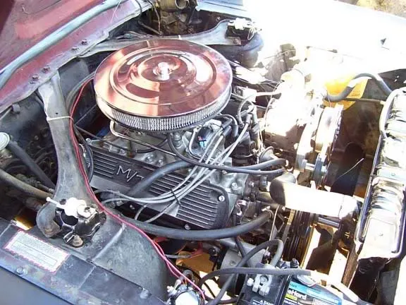

My roller 302 started as a new 302 block and has the following:
-Stock crank & rods
-Speedpro forged flat tops
-Crane Powermax 2031 (p/n: 444225)
-Edelbrock Performer 60379 pedestal rocker heads(1.90/1.60)
-Crane Energizer/'93 Cobra roller rockers
-Weiand Xcelerator single plane intake
-Holley 650 pumper
-Hooker Comps.
-Ford Duraspark distributor with a GM HEI module firing the coil
-Fidanza aluminum flywheel and RAM clutch
I haven't had it on a dyno, so I don't know what it's putting to the rear wheels. It does get up and scoot pretty well, though.
Scuzzy engine bay, complete with Mickey Thompson valve covers like Harndog has.

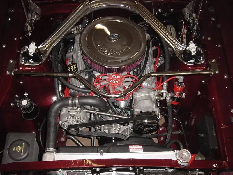

I've got dyno results from the car with a carb, don't have any with the new EFI setup yet.
306 cu.in. DSS Racing Shortblock (balanced internals, forged "flat top" pistons)
Trickflow Twisted Wedge Heads - 2.02 / 1.60 valves, Track Heat springs, unported
10:1 compression (heads are decked to achieve this)
Lunati 51017 roller cam - 218/228 duration @ .050. .536 lift (1.6 rocker)
Stock Ford roller lifters
Ford Motorsport 1.6:1 roller rockers
Edelbrock Performer RPM intake (non-air gap)
Edelbrock 750cfm carburetor
MSD Dist. + 6A box
Hooker 1 5/8" longtube headers with 3"x2.5" X-pipe
Car did 325 HP and 317 lb/ft to the wheels. Dyno chart is attached. Can't tell you what it did with the Victor Jr. I had on it for a while, but it did trap 3mph faster in the quarter with it! (109 mph vs 106).

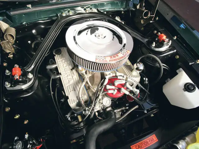

This blue '65 belongs to a long-time friend of mine. He brought it to me last weekend so I could do some (disc) brake work/experimentation on it.
Ran a 12.83 e.t. @ 113 MPH in monroe, LA. Engine specs in this link:
http://ultrastang.com/Ultrainfo.asp?Page_ID=13
Sound clip:
http://img532.imageshack.us/my.php?image=65soundclipnt3.flv
