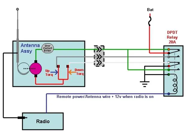

Here is how I wired mine with a DPDT relay.
Maybe it'll help when it comes time to hook up yours:
