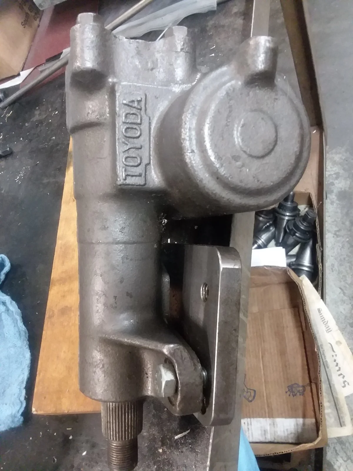

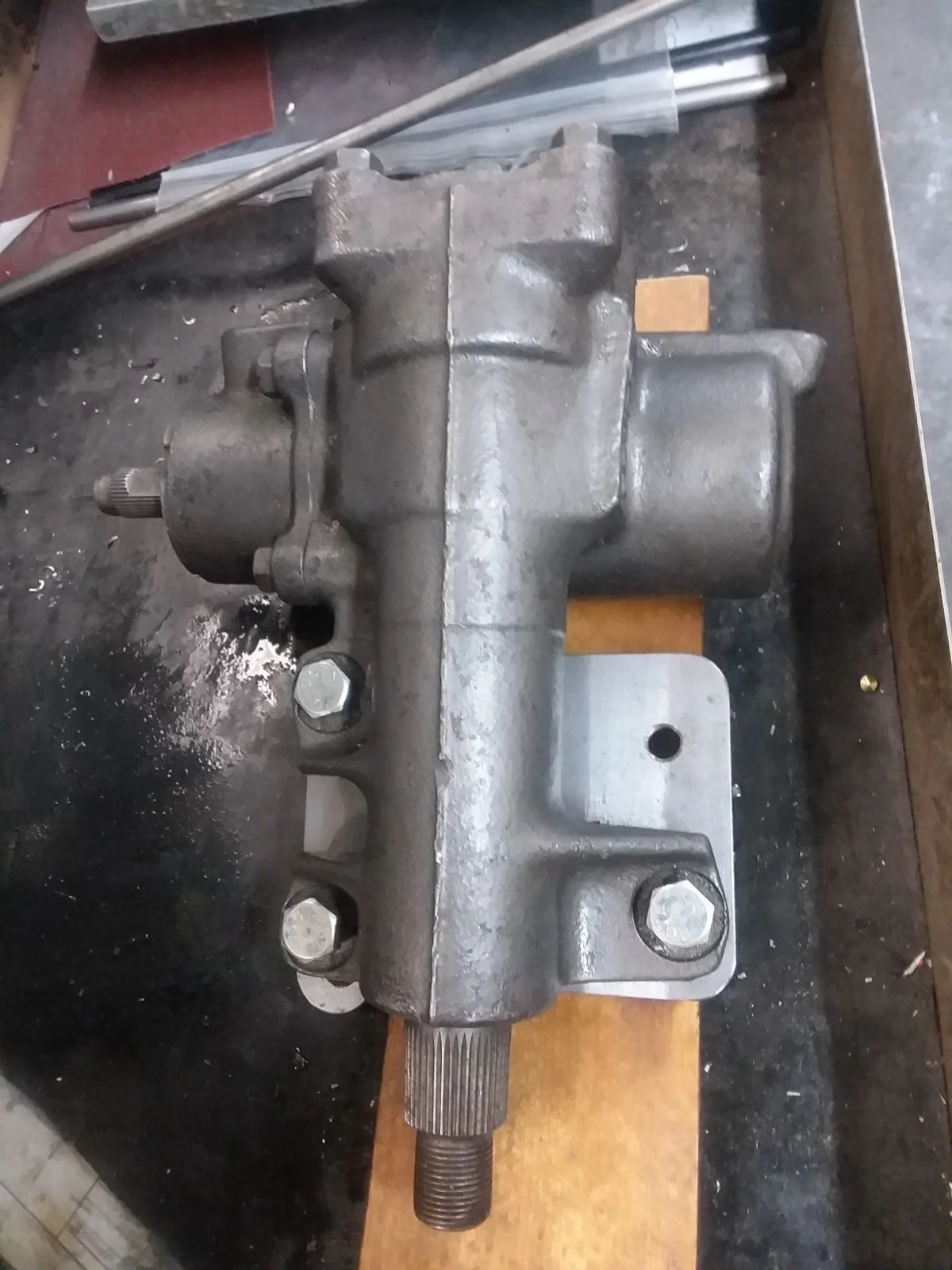

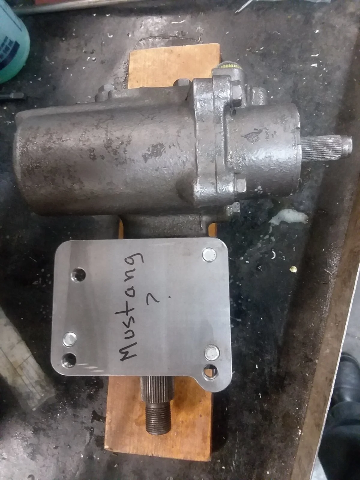

Yeah, it's interesting, but cannot be used with the stock clutch mechanism. It uses a Toyota Cressida box, and the hose outlets are on the top.
It's NOT a Toyota Cressida box.
Here is a Toyota box, notice the angle of the top cap, hose orientation, and the piston is in the rear of the box not the front like ours. Our box is from vehicles that are a decade newer.
Toyota Box:
[/URL][/IMG]
Borgeson
Jul 14, 2009
41
Not that I'd mind if it was an import part (I have a Subaru in the garage), what gearbox is it?
Really can't tell you that but some folks have guessed correct. Safe to say after we machine and alter the box it is not really recognizable as a factory part.:nice:

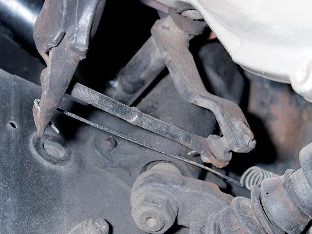

Maybe the frame side clutch linkage pivot can be moved towards the engine?
I think you could shorten the tube of the equalizer shaft and make a new bracket with the pivot point further towards the engine, out of the way from the hoses. You could use the same frame holes as the original bracket and perhaps the rear steering box hole.
