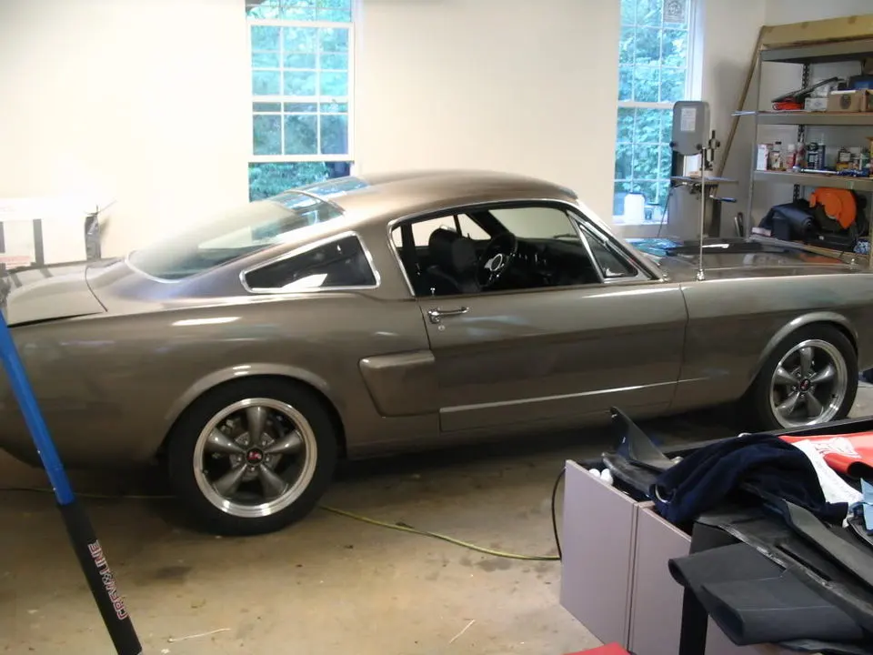

My 65 fasback is hard to steer, not as bad as manual steering but not nearly as easy as power should be. Is there a way to adjust the power on the original style set up? thanks; chuck
