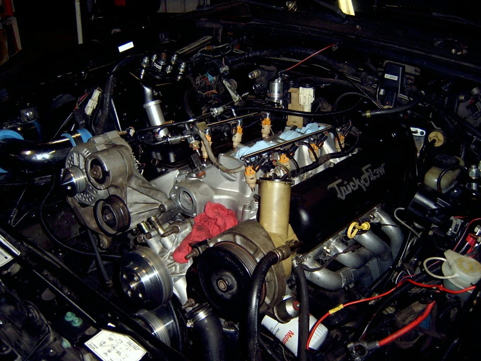

Anyone have pictures of the routing of the pressure hose when using the Ford ac delete kit? On the bottm did you run on the inside or outside of the swaybar? On the top did you run in front of the pump or behind?
If you are referring to the power steering pressure hose, here is a pic of how mine is routed. You don't need to disconnect the hose, you simply move the power steering pump up to where the AC used to be. In the pic it looks like the hose blocks the pulley, but I can assure you it does not. Hope this helps!
