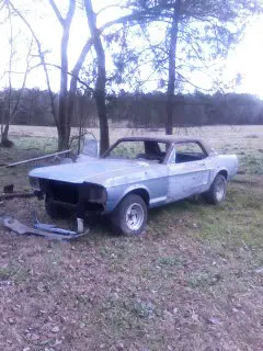

Here is my 68 coupe:
body is pretty straight, came with a clear title and alll the VINs match.
8R01T133916 65A 2B 26A 61 4W
8 - 1968.
R - San Jose assemble plant
01 - body serial code (hardtop)
133916 - 33,916 car built
65A - coupe
2B - blue vinyl buckets
26A - 26th January
61 - Dallas distric ordered the car.
4W - 2.83 rear gears with C-4 auto

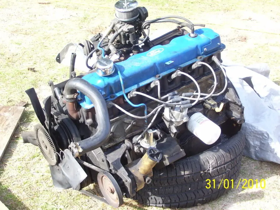

This is my 1985 300 inline, which is going to be taken completely apart and rebuilt with early 300 rods, forged 351 pistons, shorty headers, clifford dual carb intake with two 38 webers, Compcams street/strip cam, and other goodies.

Needs all new floor pans................ and maybe tunnel expansion to acommodate a T56 :Track:

if you need any advice, check over at Ford Six Performance Home/Index in the forums there. we have one dedicated to the big ford six, and there are a couple of members that have swapped the 300 into a mustang and falcon as i recall, and they can help you with information to get you over any difficulties you run across.

Turbo please .. You have so much room, and enough cubic inches to make big power with a low boost setup.
1968-coupe
Mar 28, 2010
131
Deep East Texas
Mar 29, 2010
  • Mar 29, 2010
The thought crossed my mind put that would limits me to an auto trans. Read of a turbo 300 built for a Ford truck street rod, 550hp 850 ft-bls of torque. Too much, I would lose my T56 option. Id like to see that engine in a Fox body. I may oneday build a turbo 2.3 fox. I think 325/425 is enough for my street rod.

dont need to lose the T56 option if you turbo the six, the T56 was designed to handle the power. remember that it was designed to be installed behind the viper V10.

Here is a rough idea of the engine build:
1985 300 block.
Hypereutectic 4.020 pistons
Hastings Power Flex Rings .020
Federal Mogul Mains .020 Under
Clevite Performance Bearings Std.
Federal Mogul Cam Bearings Std.
Comp Cams High Energy™, 268H
Melling H.V. Oil Pump
Eagle H-beam Rods 6.300 2.100 Rod Journal
Roller rockers (may opt for high energy rockers)
ARP Main Stud Kit, Rocker Studs,
Fisher International Ballancer
Bore 4.020
Power Hone 4.020
Performance valve job
1.94/1.60 SS valves
Performance Balance job on Steele Crank w/ in 7 grams
Grind Rod Journals to 2.100
Deck Block to Square
Align hone to Factory specs
Deck block for Zero Deck
Clifford dual carb intake manifold
2xHolley 350 CFM or 2 Webers
Clifford shorty header
(this is a modded list from another build, actual choices may vary during the building process)
