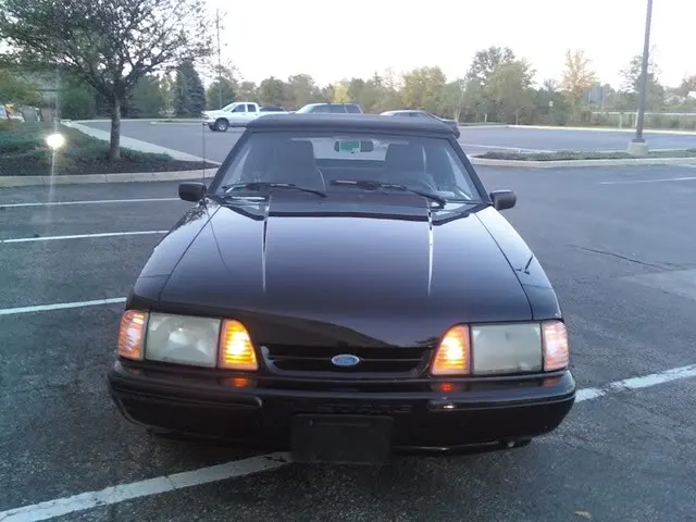

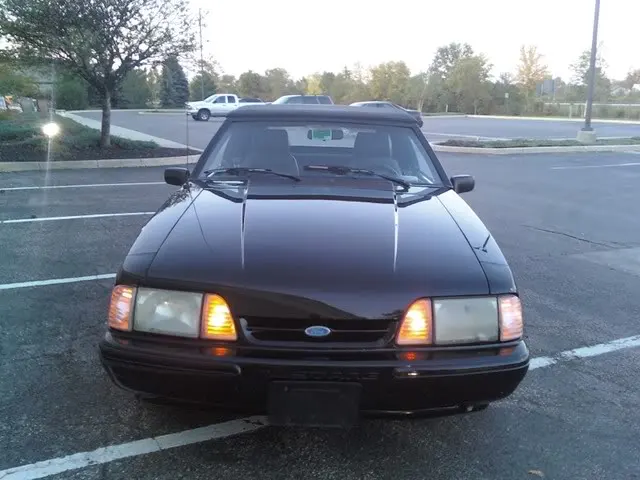

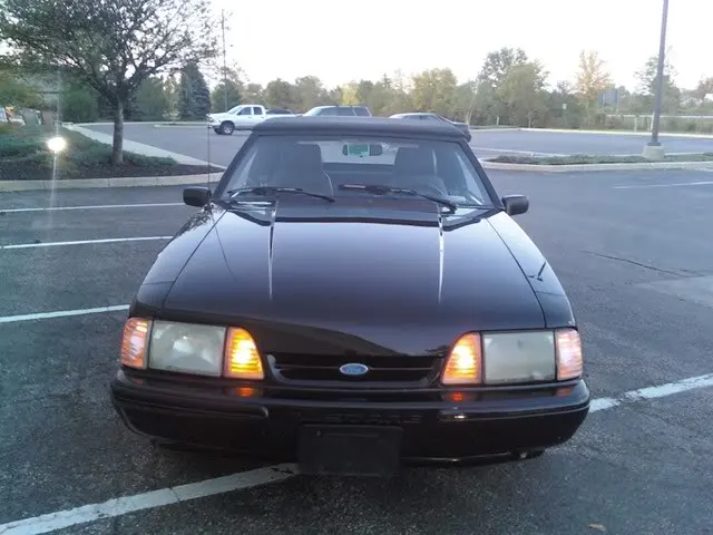

tried polishing the headlights..best i can get them too.
Mine were the same way. I wet sanded from 1200,1500 and 2000 (soapy water), and then hit them with 3M perfectit compound and polish with a professional style buffer. They came out like brand new.
Car's lookin sweet man

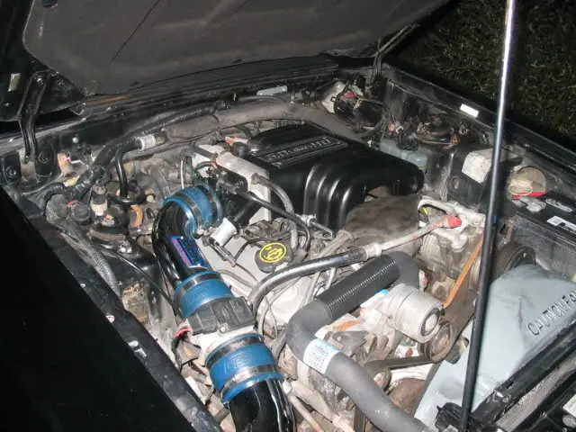

have pics man? and thanks. it will be getting dynoed soon
so..guess my numbers! the car feels very stout. like old mustang. compared to this one a world of a differene.. i tried out the posi today..lol. this is seriously. the most powerful stock 5.0 ive ever driven. i think the motor has been pulled and rebuilt at one time. it runs so smooth. doesent drip a drop of oil. the block is clean. oil pan. new gaskets hoses everywhere. for having 142k on it. it sure does not run like it.
so..guess my dyno numbers!
only thing it has is...
dynomax mufflers
BBK CAI
so basicaly. bone stock. with 2.73's

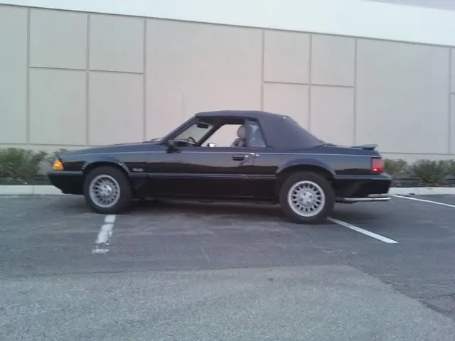

Got to meet Ryan today at our local cruise in, snapped a couple shots of his car. I can say with complete confidence that this is much nicer than the other 2...you STOLE it for the price you paid.
