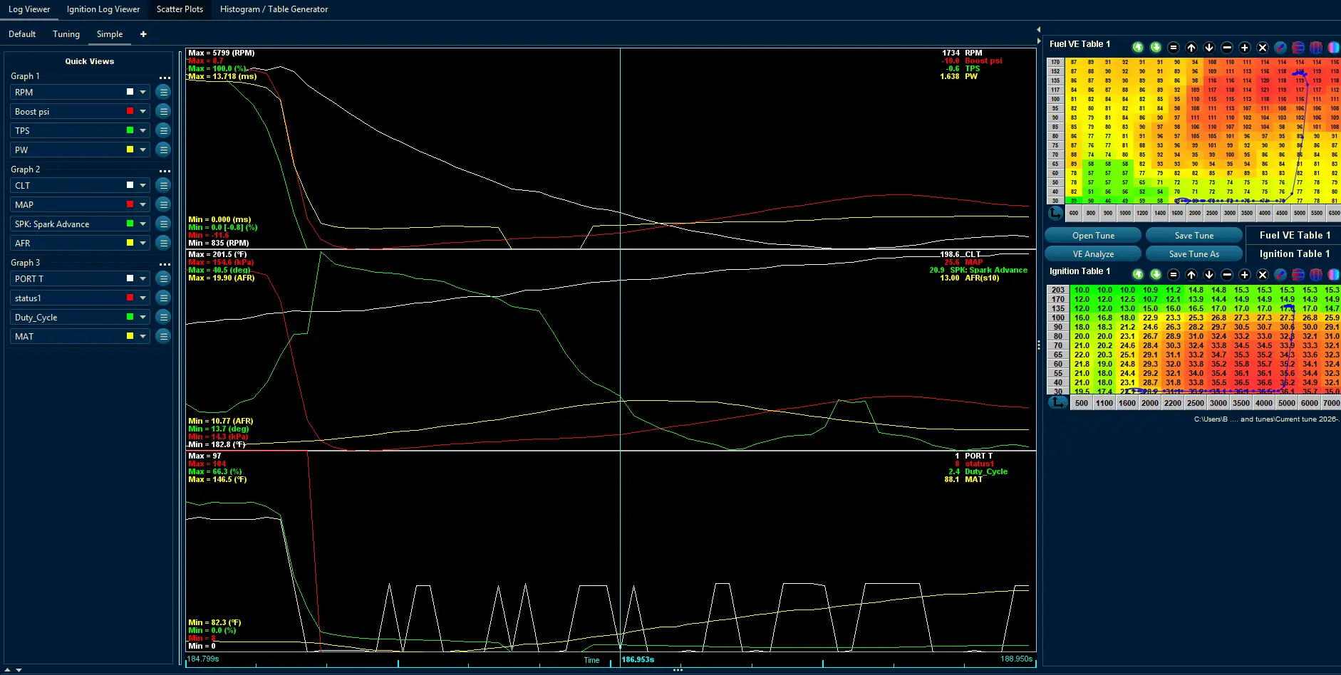

Possibly. I think it's making enough vacuum when I lift off the throttle, but that still doesn't rule out the booster. It is original to the car. You can see in this log, the MAP KPA is pretty low when coming off the throttle after a hard pull. MAP is the red trace in the middle box.

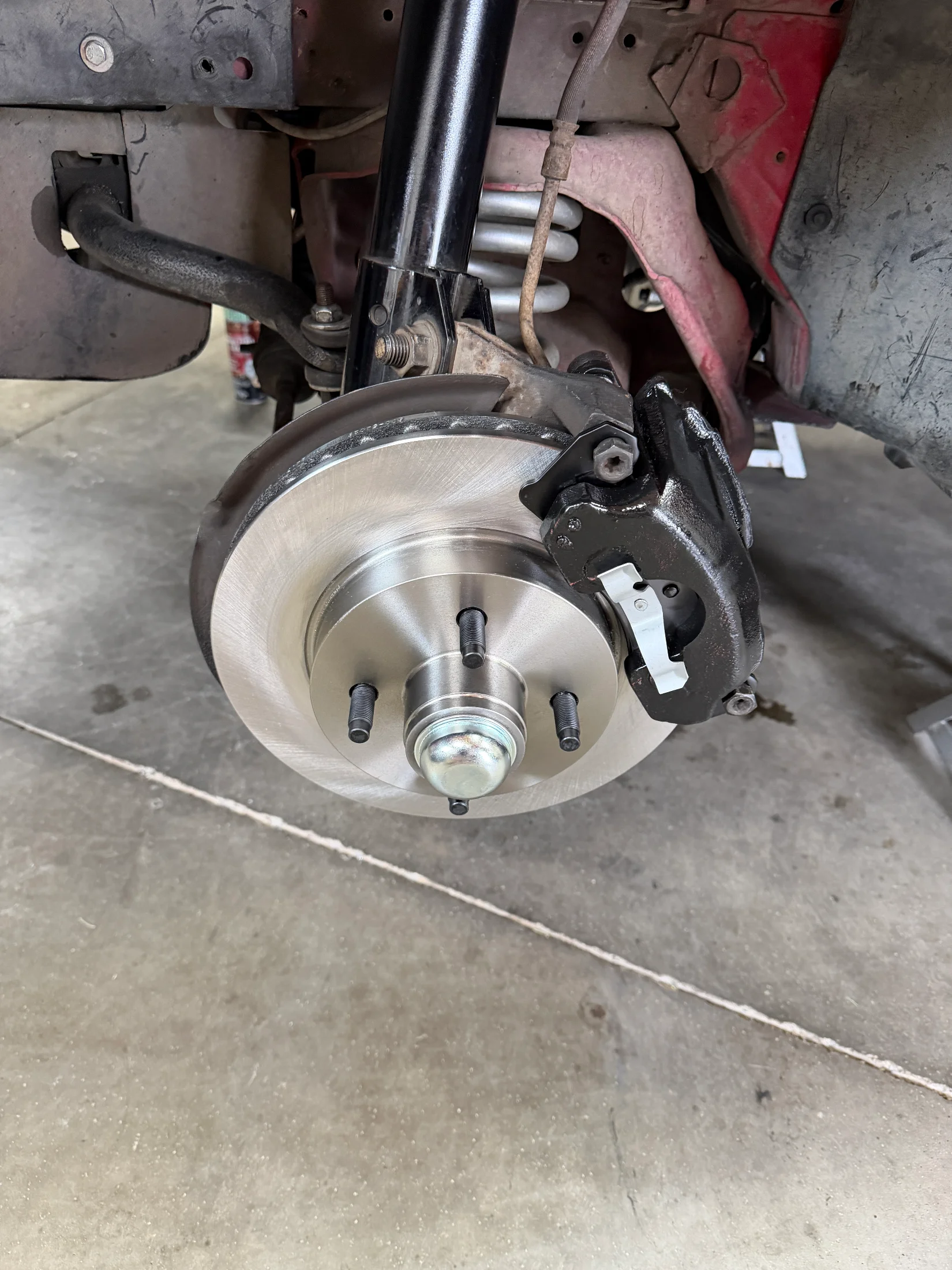

Already received my new parts, and had a rainy cool day to work in the shop yesterday, so it's all installed. Winters are long here in ND, so I'll need a project anyway. I'm going to convert to rear disk, but I need to find a kit that will clear my 15" Weld wheels with my drag tires on them.

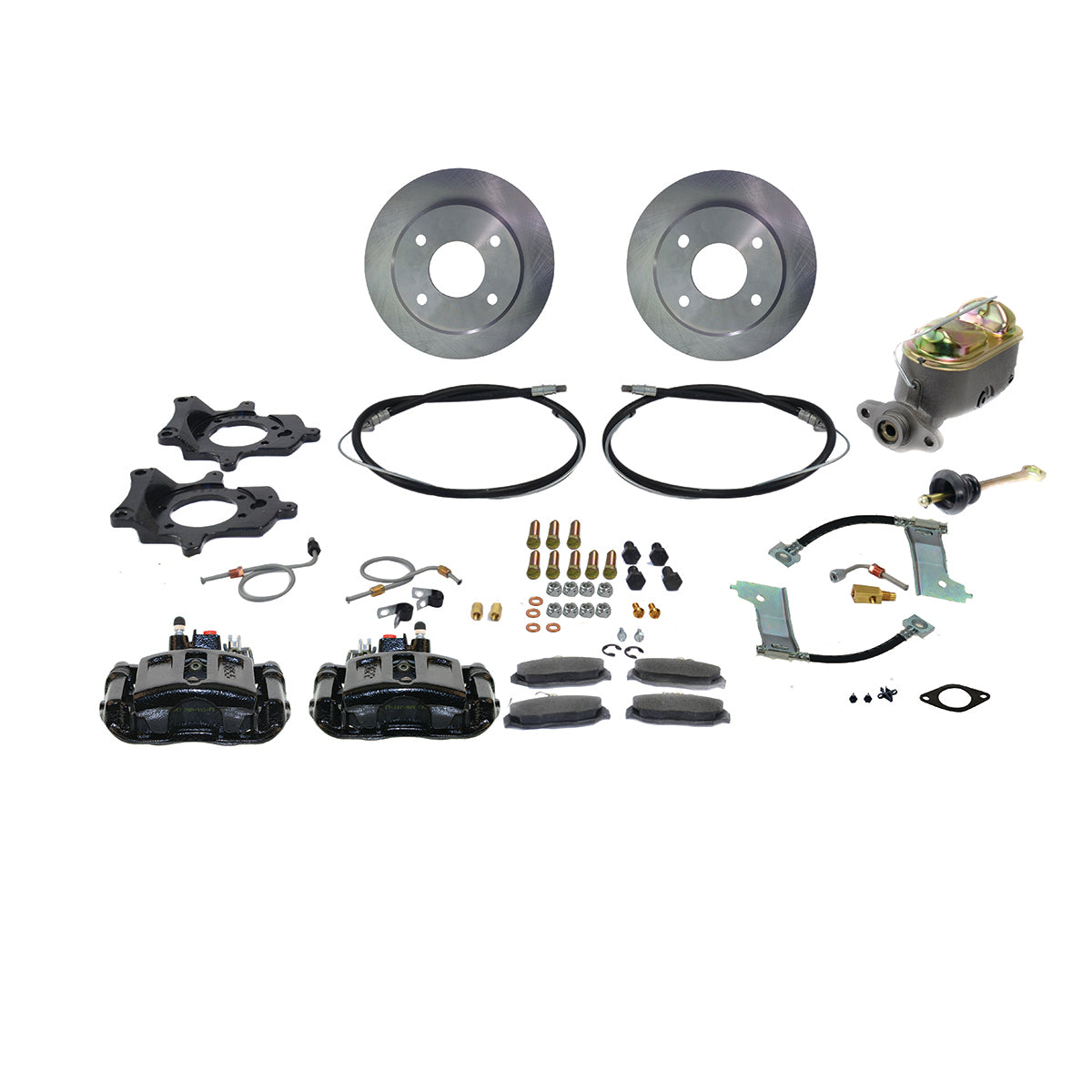

Looks good man! I know for a fact the SSBC rear disc brake conversion will clear on 15" Weld Draglites. These are the exact wheels I ran with the kit:
And this is the kit:

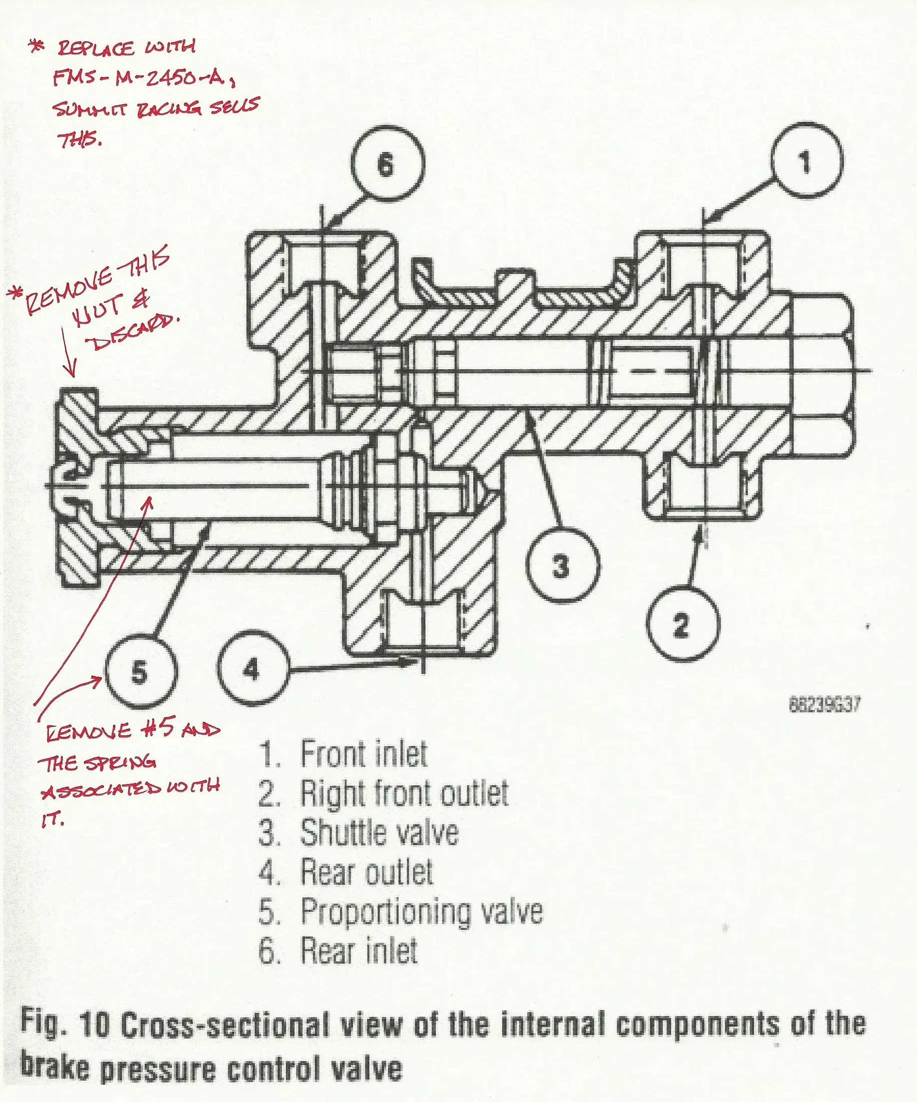

It is basically the same as the 87-88 Turbo Coupe / 1993 Cobra rear disc brakes. The master cylinder is a joke to just punt it into the trash and get a 1993 Cobra MC, a 3 to 2 conversion kit, brake proportioning valve kit, and a manual proportioning valve:
Diagram on what to gut on the combination valve:
Try the check valve first. Pull it and test and make sure it's still working as a one-way valve. You might be working off straight vacuum which is why it gets hard after a long pull if you haven't even touched the pedal. The check valve should keep a reserve in the booster for 1 or 2 presses.
Reactions: Sparky714
Interesting, Where is the check valve? Edit: Google showed me where it is. Did not know about this valve, and definitely going to check it out. Thanks!
