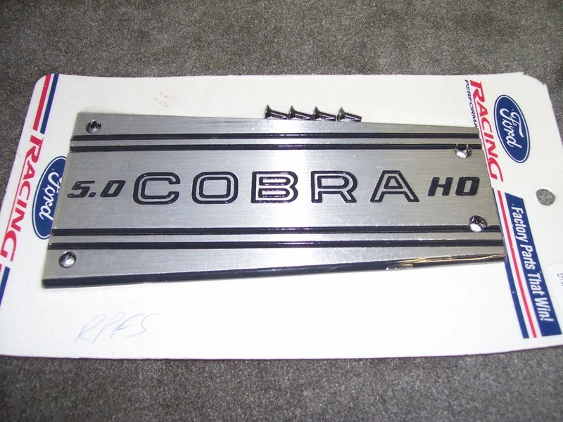

I got one of these seemed legit when I was 15.

Hey Ford Racing sold it, purposely misled me by sticking Cobra plate on an H.O intake it would fool people haha

Funny thing when I bought my ported exploder intake and 70mm TB off this guy for $150 he threw in this intake cover plate.... I've seen this plate sell for $100 alone.....
