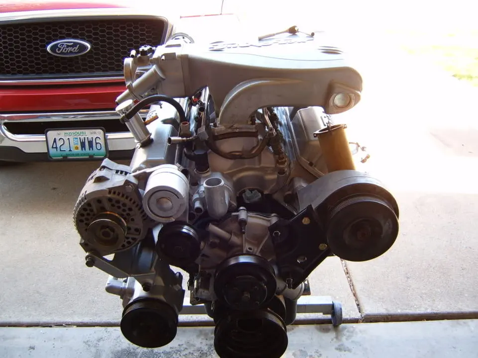

other than that being a cheap replacemnt tensioner, it looks positioned correctly to me.
reference pic with a factory stock tensioner
