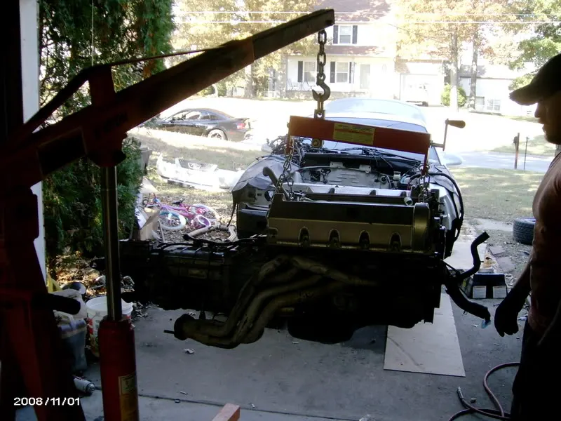

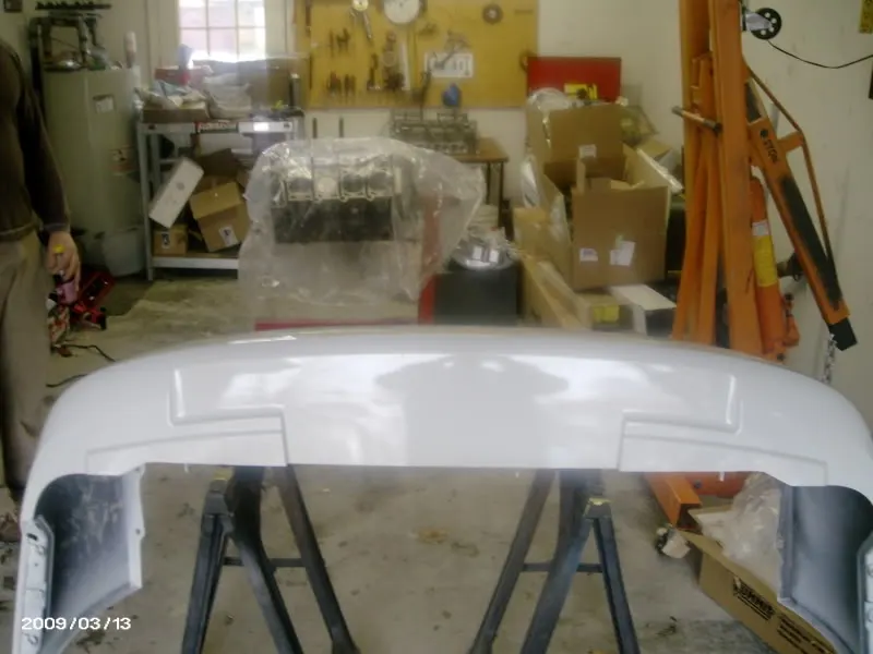

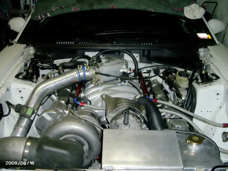

I build some of the fastest mustangs in my town and have pulled dozens of 4.6L engines in 2 hours without being ghetto and cutting crap. I can pull my entire car apart right down to just the body in 6 hours. Just because you can't do it doesn't mean others can't.

And its all done in a 1 car garage with basic hand tools.
