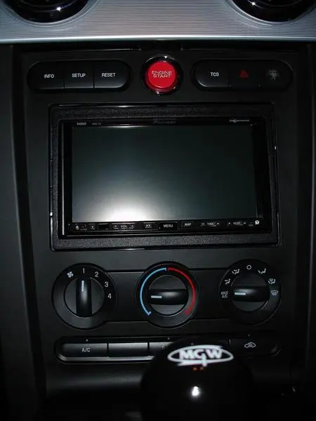

Here's mine ... S200 button.
If you still need your key in the hole to be able to use that button to start... What is the point?

I did the FRPP one just last week. It took about one and a half hours start to finish, and is really easy to do. If I had to do it again it would probably take less than 45 minutes! The instructions really are idiot proof!
It's probably the cheapest mod I've done to date, yet probably one of the ones I like the most.
What's the point? It looks a whole lot better than the stock power button cover and anything else that's out on the market. It also works, it's not a faux button.
