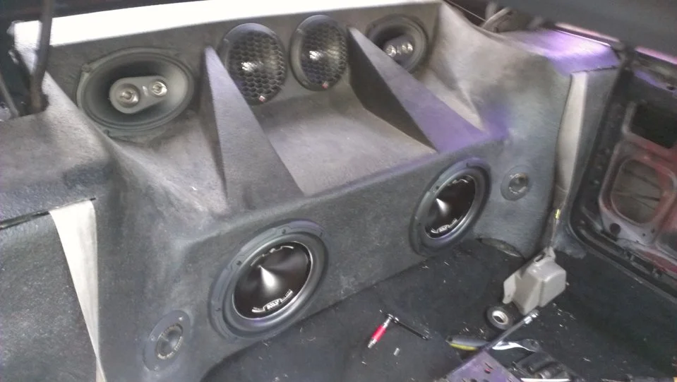

I can't be too synical my entire back seat is a speaker box

What is that, 6x9's, 8's, 12's, and tweets? I want to take a ride sitting in the middle of that on a cool day with White Zombie's more human than human blasting away

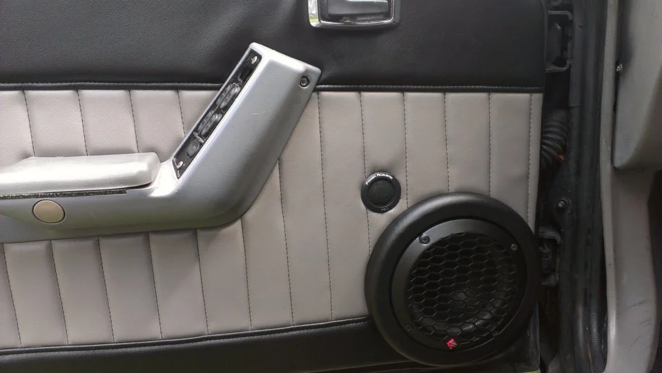

6x9 mb quart, 8" loud speakers for mid range, super tweeters, and now it has competition jvc arsenals 10" all the highs are driven by a 1500w 4 channel class sq, the bass has 1500w mono class d amp. All figures are RMS it can demand 300amps from the two batteries in the trunk at full load.
Of course that requires a 3g upgrade and 200amp alt.
I also custom my doorsSorry for the

Thanks it only took 16hrs and 2 gallons of resin. I would do it different if I did it again.

Well its in a convertible so I went for sound quality, the amps are capable of much more than I ask of them... if you have a driver (amp) capacity larger than required and keep the gain turned down you get a sign wave that does not distort. All the speakers share the load, more speakers driven with less power will have less distortion than a few driven by a large load.
Sorry I just nerded out.
But yeah turn up at full blast it's hard to sit in the car....
