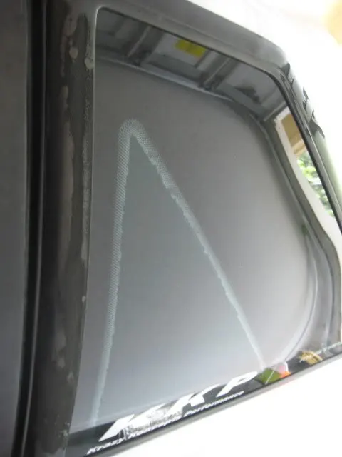

Can they be saved? Possible to sand em down instead of going out and paying $70 each + shipping :shrug:
I was thinking of bringing up this same topic, Turkey your windows would be an upgrade compared to mine. My windows look and feel like 40 grit sandpaper all around, and when I wash the stang wax and lint gets in the gritty moldings.

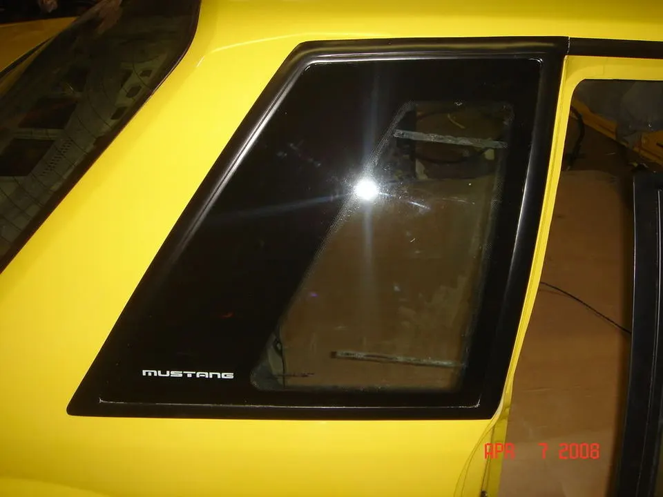

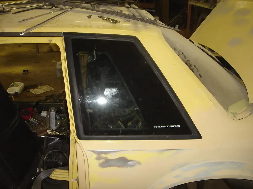

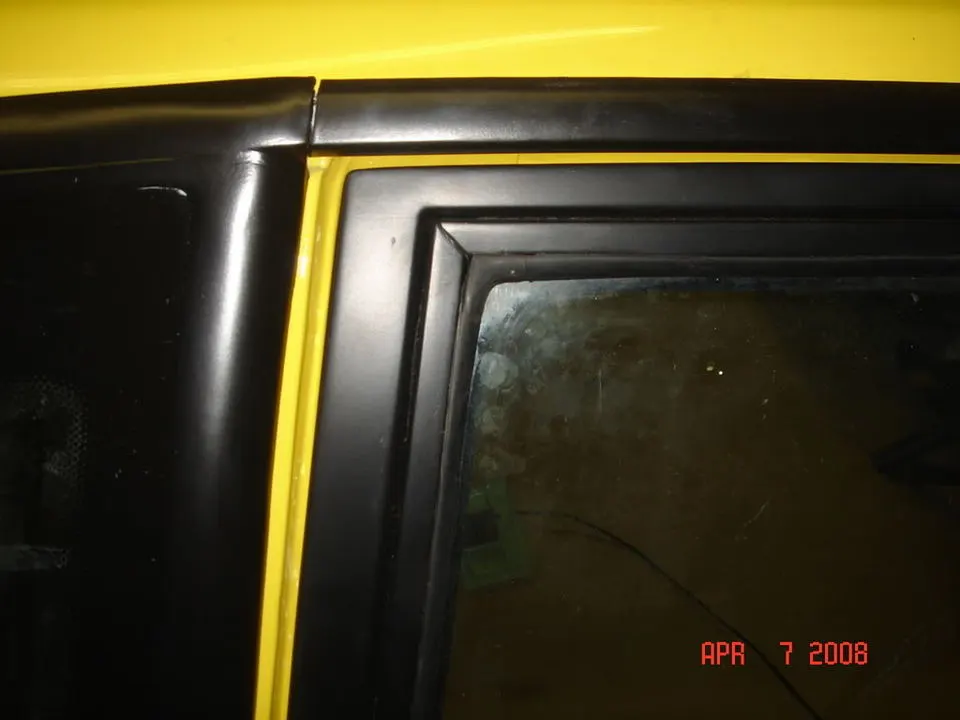

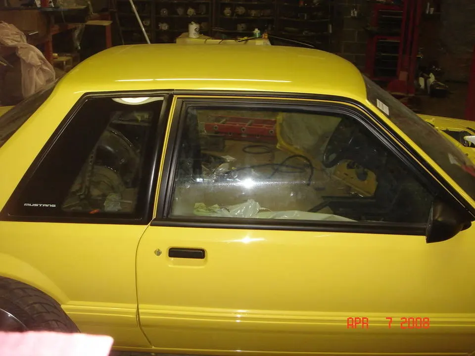

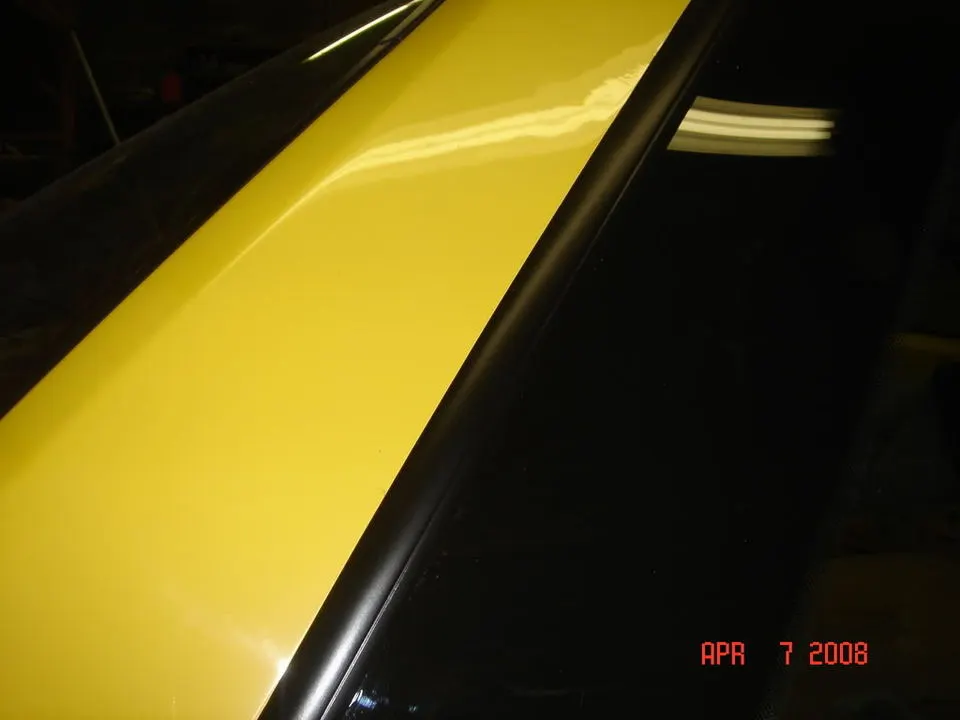

Sammich....I have one before shot. it's far away...but mine were just as bad. I sanded them with 80 grit on a DA sander. Then I laid 4 coats of high build SEM primer and sanded them with 320. I repeated this procress until they were smooth. Next, I painted them with SEM flat black flexible paint. Then I cleared them with SEM Semi-Gloss clear coat. You must do this. I didin't clear coat the first set I refinished, and they slightly lifted later on down the road. Buy the clear coat...trust me. Don't spend 70 each, spend about 20-30 and you'll have what I have.
Here is my only before shot:
Here are my after shots.
