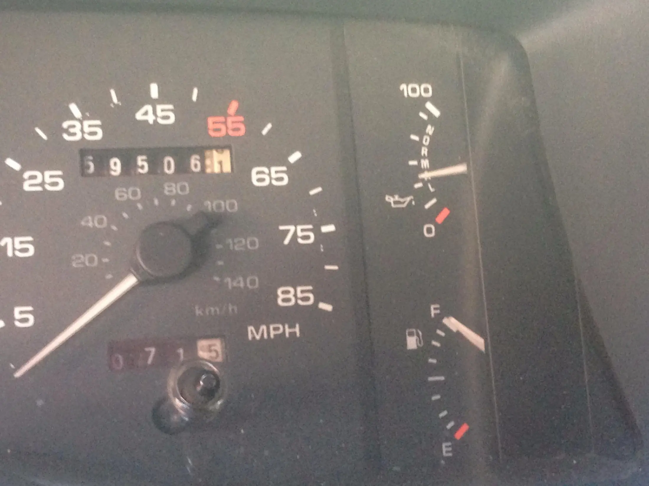

is anyone able to tell me what the oil pressure readings at each needle of the gauge would be? I know M should be around 50
The sending units are notorious for being all over the place and failing. Only way you will know what yours reads is to use a mechanical gauge in parallel and then you will know for sure.
