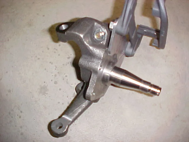

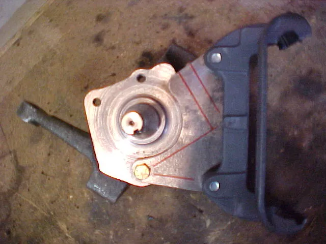

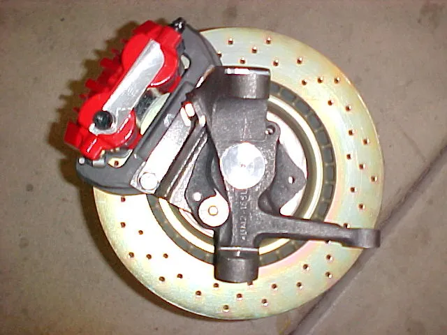

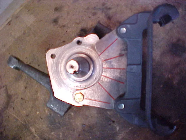

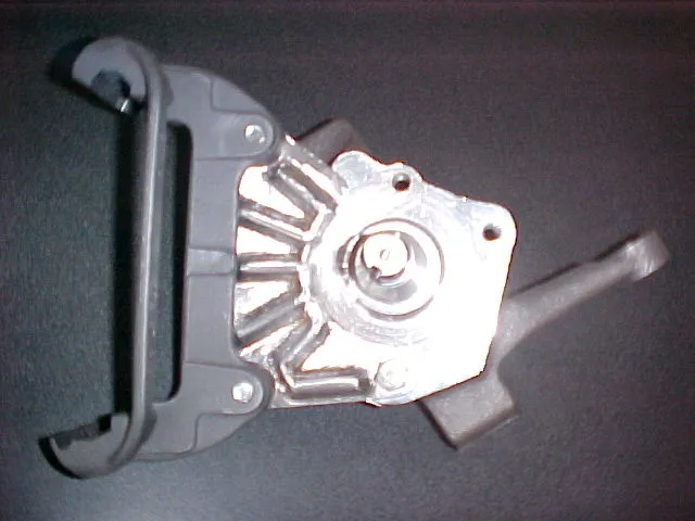

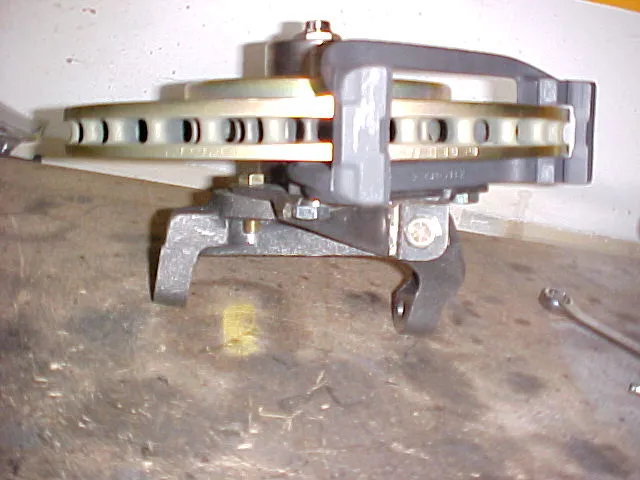

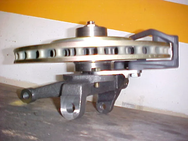

I came across a guy on the Corner-Carver's Forum (http://corner-carvers.com/forums/index.php?) that did the exact same thing, only he used the 12" Cobra discs, calipers, and fabricated 3/8" thick brackets on a cut-down Granada disc hub and aftermarket MII 2" drop spindles (http://corner-carvers.com/forums/showthread.php?t=22199). Unfortunately his pics are long gone, but I made copies. ;)
He ended up adding some reinforcing weld to the adapter plate, but it would have probably been better to use thicker plate and machine out reliefs as needed.

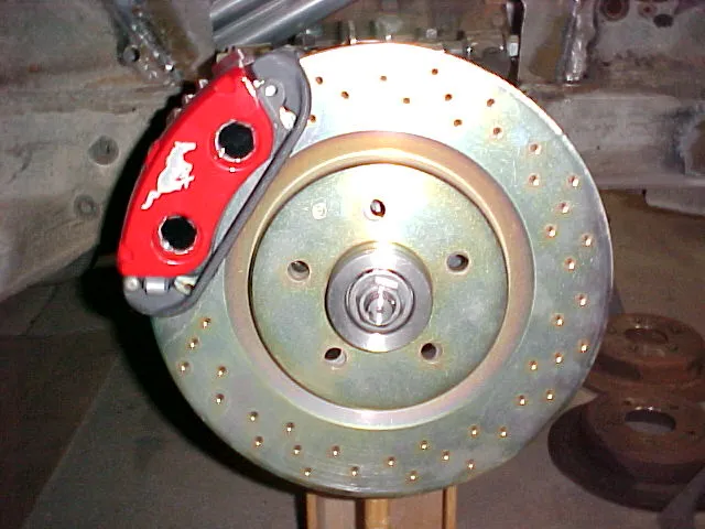

This should be it...
I was thinking that this would be doable with a larger ('93 Cobra?) set of 4 lug Fox discs and SN95 calipers also.
