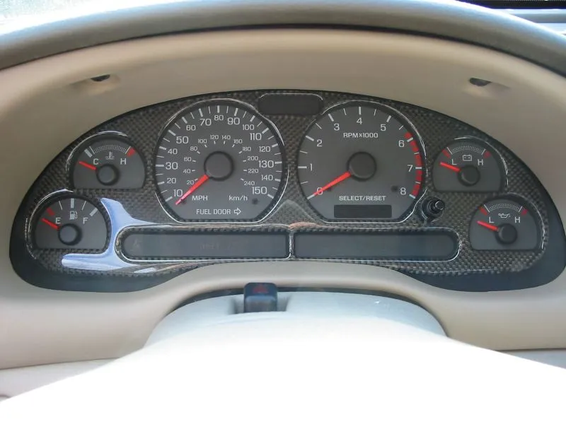

jadesville,
Check out this pic. I will tell you that installation took me a while. The clear lens on the cluster was glued on to the black gauge frame. I took it completely off, since I didn't see any way for the carbon fiber cover to clear the odometer reset button without doing so. If you decide to do this mod, be prepared to buy a new clear lens. I got mine out without destroying it, but I did get a few hairline cracks around the edges. I used contact cement to re-install the lens. Looks pretty good though...well worth the effort.
Bill
Last try...
