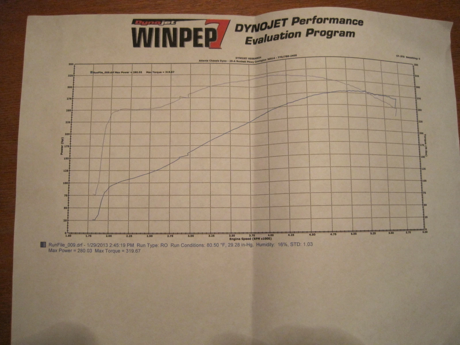

I have a similar combo, but ported cobra/lower, race ported gt40p heads milled .30 with and Ecam. You can can only do so much with an Ecam but using it as a DD is Awesome. I drive the car so much now. They would be similar to my numbers for sure.

This is my Ecam flat torque curve, It's so much fun on the streets. But like ^^^^ they said if we had a better cam the hps would certainly go up but the torque curve would change. I only have 1.6 rr on this as well so I'm not even breaking .500 lift, no doubt the cam is holding it back and 300hp is doable. Believe you said you're doing 1.7 rr so that's a bonus though.
