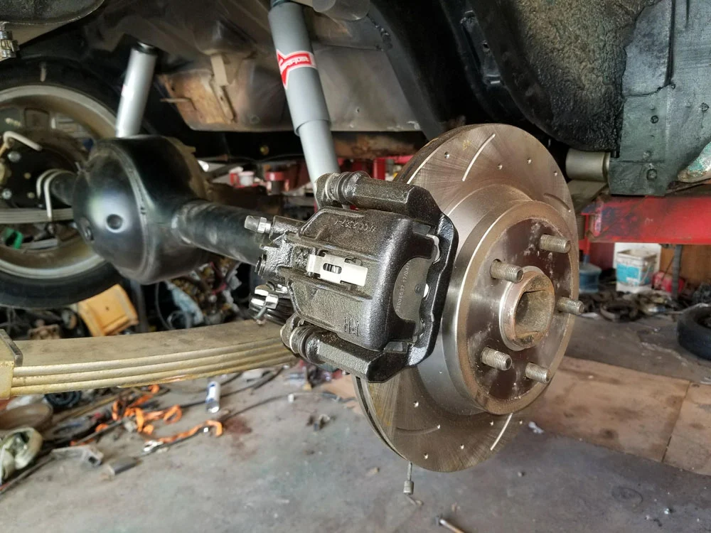

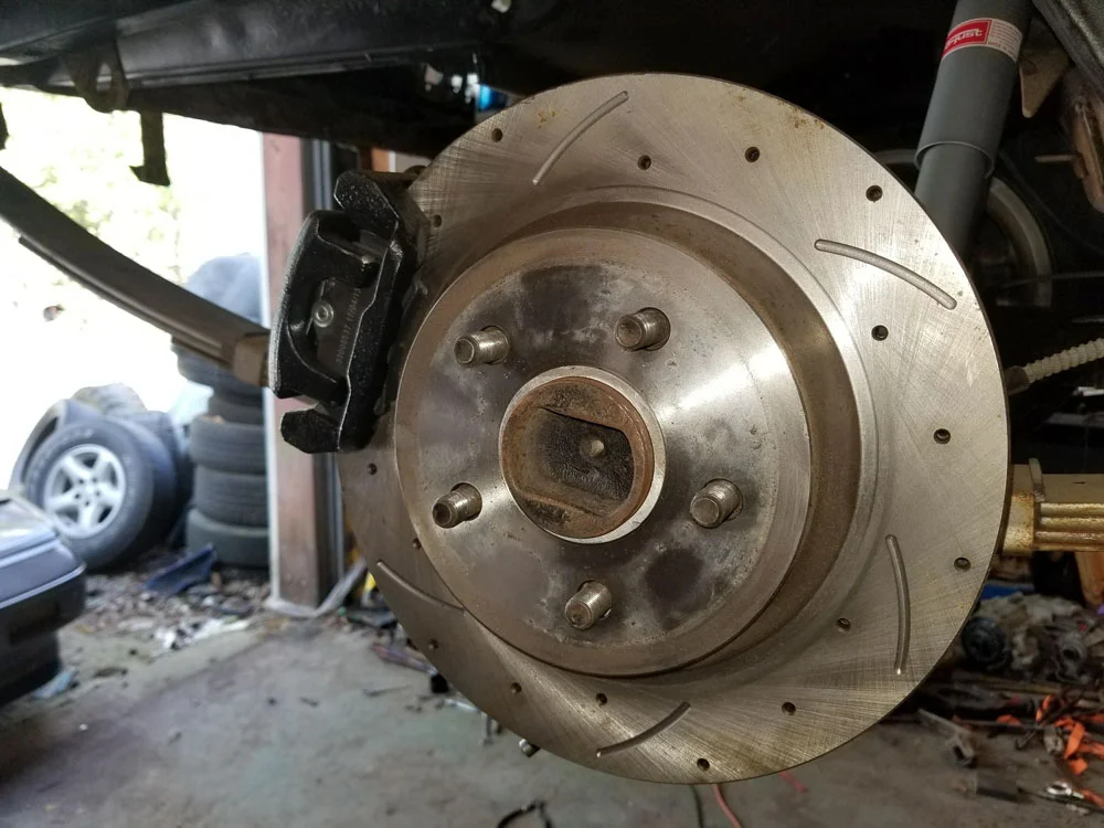

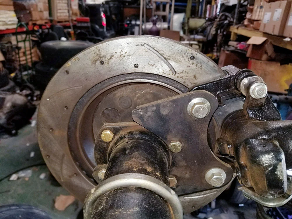

Hey Guys, it's been a while since I posted. I developed a rear disc brake conversion kit that adapt 94-04 Mustang and Mustang GT rear disc brakes to the stock small-bearing 8 and 9 inch housings in early fords. I have been using them in my 67 coupe on both the street and track for several years now, and on my 67 T/A racecar. They proportion extremely well with the factory front 4-piston KH disc brakes, fit inside a 15" wheel, and don't change the track width. I'm selling the bracket kit for $150. You will need to source your own calipers, rotors, and hoses (I've purchased used sets for as little as $50). Let me know if you have any questions or check out my website for more information https://www.vintageraceworks.com/products/rear-disc-brakes
Here are a few photos of the kit and install:
I've used both the stock disc/drum master cylinder and the SN95 Cobra master cylinder with this setup. I recommend using an adjustable proportioning valve to dial in the braking system to how you want it.
