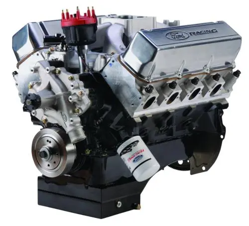

Well, for a little over 9 grand, you could get this 580 horsepower Ford Racing engine. Since the 71-73 Mustang was designed around the Ford 385 series engine, it would pretty much bolt in. Of course, you're going to need a tougher transmission, and your 28 spline rear axle will need a lotta work to take the power.
I say this because you can get a nice, crisp engine out of modifying the 351 2V you have, but it's not gonna keep up with a late-model Cobra.

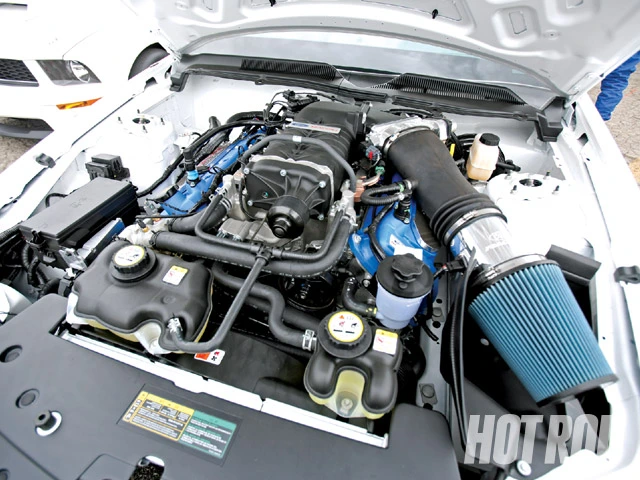

Yeah, a nice crisp, even snappy 351C. And I love the old Mustangs, even the "big" 71-3.
But faster than this?

Of course i have way to much money into my car, but i frequently outrun supercharged and the like cobras. the more you spend, the faster you go.
