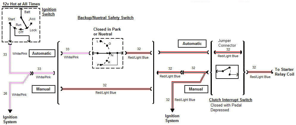

From veryuseful.com
I bottom right shows the wire color top left shows the start circuit

Typical start circuit...

See the Typical start circuit diagram above for wiring information for troubleshooting.
