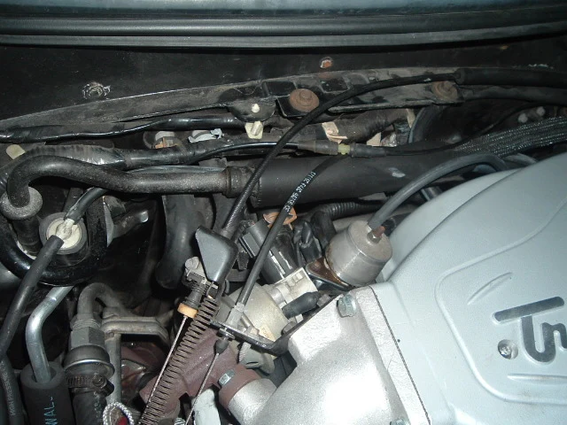

What is the procedure for removing a adjustable fuel pressure regulator? It smells of gas (must be a small leak) and it is causing my car to run really rich. So I am getting rid of it.
I assume that is what this round thing is behind the intake:

:lol: shows you how much i know, huh? :rolleyes: can you tell from looking at mine if it is an aftermarket adjustable one? :shrug:
yeah...that looks adjustable to me. basically you hook a fuel pressure gauge, pull the vaccum hose off of it, use an socket/ratchet to lossen that nut on the top middle then use an allen head to screw in (or out depending on where you are trying to put that pressure at) then tighten up that nut then put the vaccum hose back on
