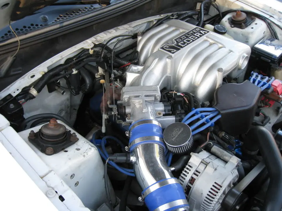

I removed mine awhile back and i'm so glad I did. It cleaned up the engine nicely. I got some thermactor plugs from the dealer and put those in the back of the heads where the steel tube bolts into. Also there will be 2 vacuum hoses you will need to plug too.
This is a pic of AC and smog removed. Look at how much more room there is!!
