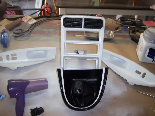

ok, so i took out the switch panels to repaint them and decided to take out the trim around the radio and the stick shift and am painting them white. Heres what i've done so far
1. I removed the trim and cleaned it off real well with dawn (dirt and grease remover).
2. I then took some 400 grade sand paper (it was either that or 100 cuz thats all i had in my garage) and sanded the hell out of it.
3. After that i cleaned all the dust off from sanding and used a hair dryer to make sure its completely dry before paint.
4. Then i put a ton of very light coats over it untill i'm satisfied with the color.
5. Now i'm letting it dry and wondering to myself wether i should put some sort of polyurethane clear coat on top.
The spray paint i used is called "pure white" from oreilly auto parts... do y'all know of any auto-polyurethane spray can i can use or what kind of substitutes i could use instead of that?

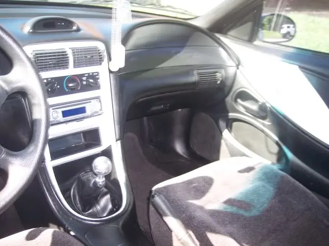

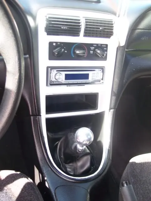

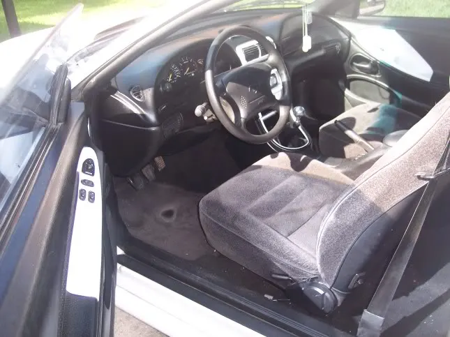

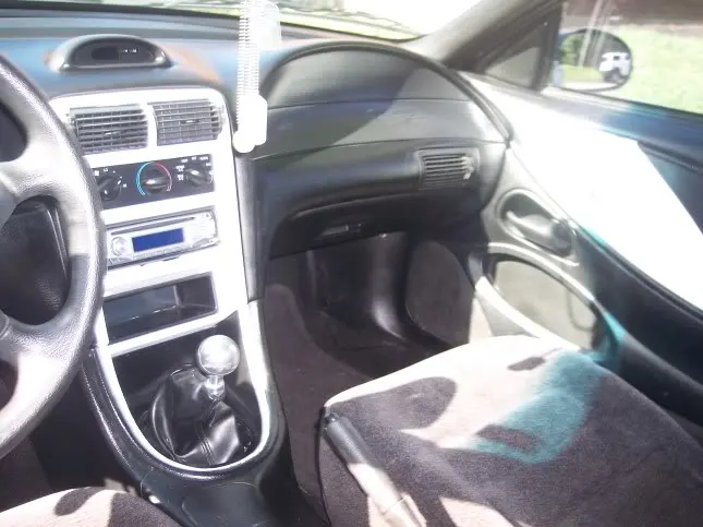

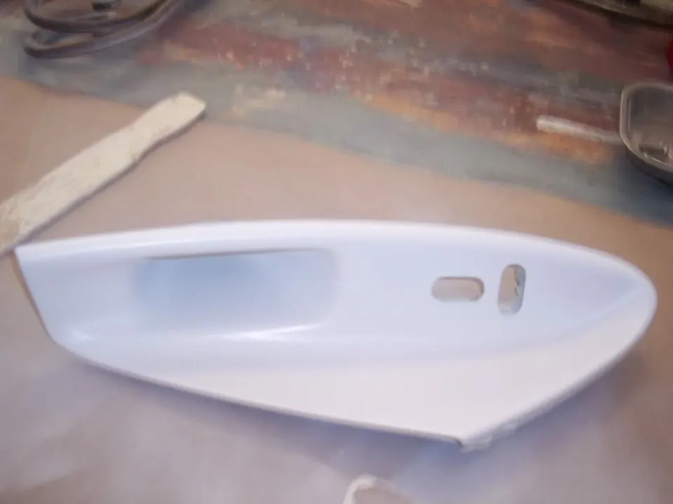

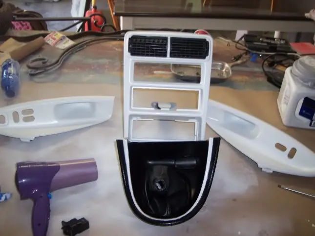

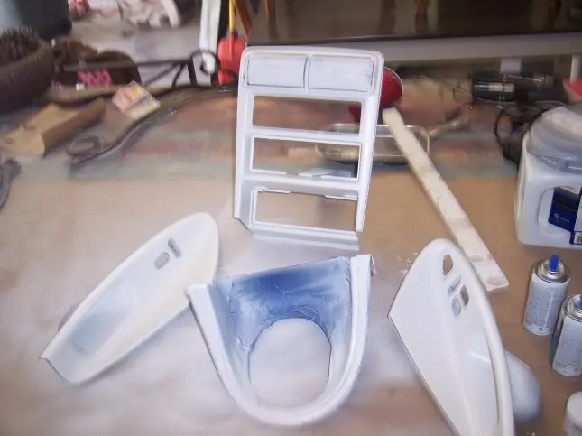

ok heres a few pictures.... i'm fairly pleased with the results although when i was doing the trim around the shifter bezzel i should have taken more time to make it look straiter, so i'll probably redo that in the futre. tell me what y'all think:

looks good. if i were you, though, i'd paint the black inner part of the shifter bezel, too.

That looks great and does wonders to break up the sea of black in our interiors!

it looks really nice, but i agree with punisher/paul, the inner shifter area would look good painted as well

well, i've seen other cares that have painted that area and i figured that its probably not a good idea especially for white because i can see it looking really dirty down there in a couple months. Also, i just wanted to be a bit different than the standard "i painted my interior" job.
Although, i might try to pull out the plastic surrounding the vents on the passenger side and to the bottom left of the steering wheel and paint those white as well. The only reason i'm dredding doin this is because i'd hvae to go buy more paint and the nazzi lady at the counter of oreilly auto parts won't let me buy it alone because i'm 17

What seats are those? They don't look anything like my stock seats?
